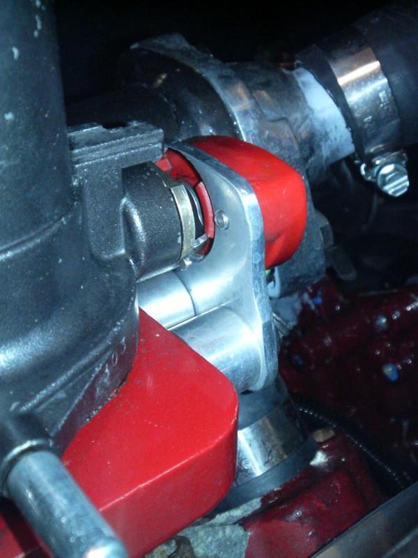

i have dellorto drla 45's on my engine, i rigged a red ford TPS on the end of the throttle shaft, well more accurately there's a slot cut into the spindle end washer which the tps arm locates into
i'll post a pic when I get one... working the map for 8 inlet runners was too much like hard work for my application!

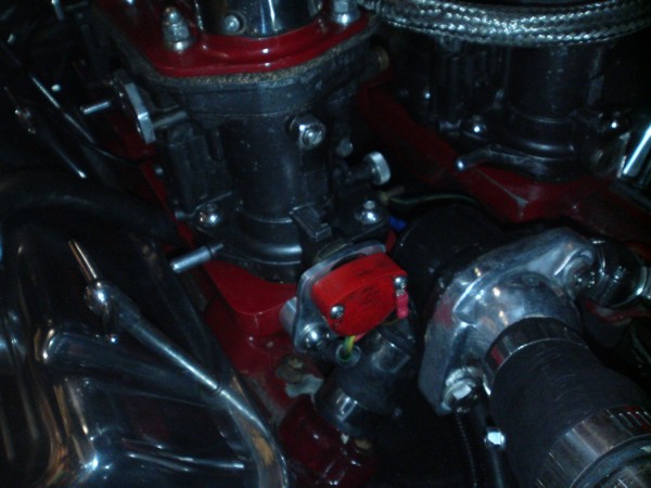

the tps unit I got hold of (off a ford fiesta, focus or puma, I can't remember!!!!) has a lever actuator at the end rather than a d-slotted hole. made up a simple mount and dremmel'd a slot in the staked on washer on the carb spindle.
anyway, a picture tells a thousand words, so here's three thousand words worth...
you can just see the tps drive lever in the slot

mounted to the manifold

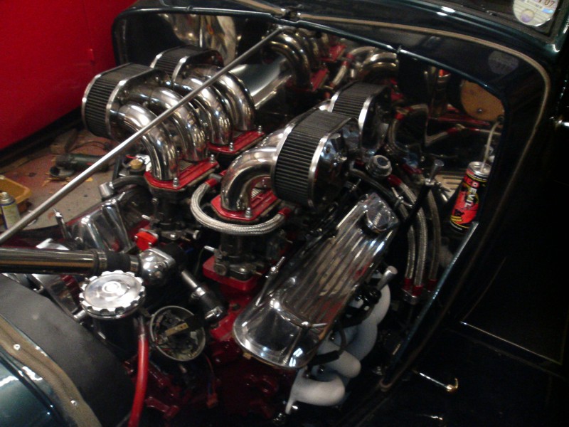

the whole shooting match! the naked dizzy confuses SO many people!

As an understatement.... that is QUITE an engine! Ta V much for the 3000 words, much appreciated. A motorbike TPS was suggested to me as well. Will see what I can find and mod as the MJLJ board I bought is already setup for a TPS.

there is no reason why the TPS HAS to be on the carb, it's designed to tell the MJLJ how far the throttle is open, but as it's calibrated by software the TPS can be anywhere as long as it's connected to the throttle somewhere.... so, pedal, carb, or in the VW configuration, it can even run off the throttle crosslink bar.. just a thought!
