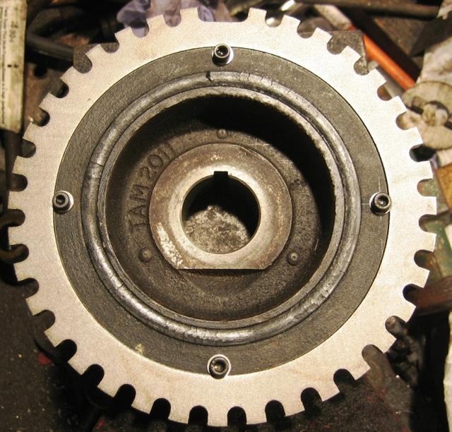

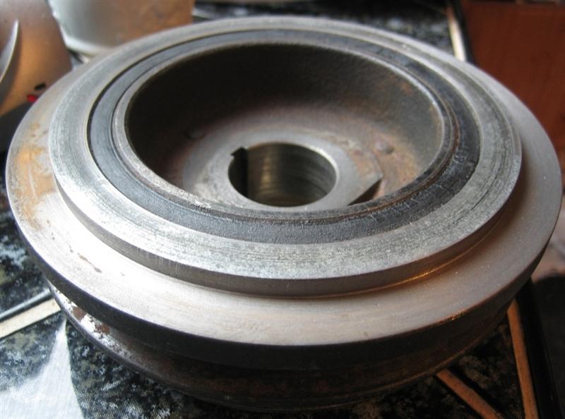

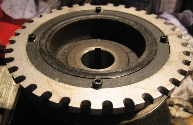

here are a few pics of my wheel...
first get the pulley machined, needs to be a nice fit, and the recess slightly shallower than the wheel thickness (i had mine done 4.5mm, and wheel is 5mm)
Then drill and tap 4 holes to clamp the ring.
