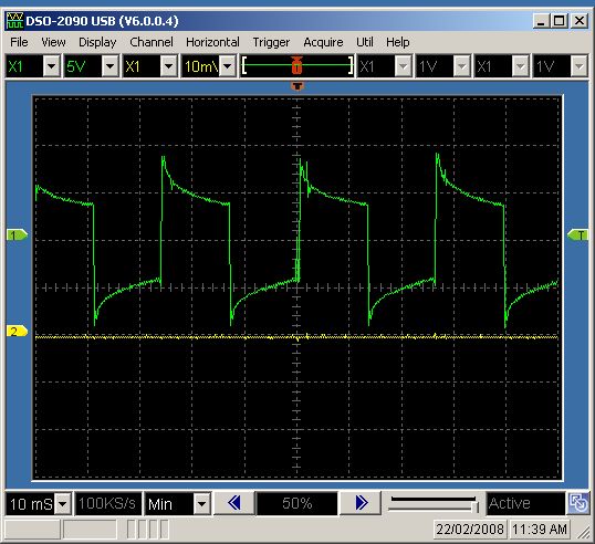

first, the pip signal measured where just before the plug into the mj. the square wave is obviously not very square, and this is with my hand touching the case of the mj.

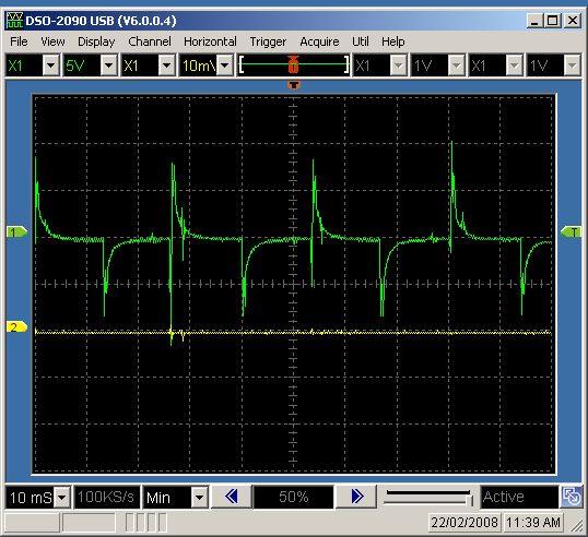

second, the same PIP signal, but without me touching the case.
there is no detectable SAW coming out.
what does it mean?
what does it mean?

ok i am going to answer my own question, for the benefit of anyone who might run into this sort of problem.
problem was the connecting plug. specifically, those pesky pins in the plug had pushed back too far into the plug, leaving the PIP signal pin out of reach of the corresponding pin in the mj unit.
i was measuring the the PIP signal before the connector, but had the scope earth wire on the mj body. somehow it was picking up a very weak signal getting into the mj (how??) via some path, a path which was significantly enhanced simply by me placing my hand on the case. not sure how, but there it is.
having detected that the PIP signal could not be seen on the mj side of the case mounted connector, i pushed the pins harder into the plug, and viola. we now have an operating device again with a SAW coming back out.
