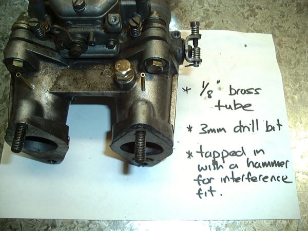

*no you dont need a plenum if you have a single manifold fed by a single carburettor.
*a suitable vacuum takeoff is really easy to install...
just select any accessible spot on the manifold.
i drilled a 3mm hole and used a piece of 1/8" brass tube. the tube is fractionally bigger than the hole, which allowed me to lightly tap the tube in with small hammer, for a light interference fit. no soldering or gluing required. too easy!
*my feeling is that mini fuel filter in the line is probably a good thing anyway to ensure that oil and petrol vapour dont make their way up the pipe to the MAP sensor.

- tubes in manifold 4 - small.jpg (56.08 KiB) Viewed 8488 times

fyi, the vac advance is done like that to reduce advance at idle, to make it easier to achieve a stable idle speed. you can test if your carby is like this: put you finger over the end of the vac advance hose. can you feel vacuum at idle? probably not. can you feel vacuum just off idle? probably yes.
and.. to answer the specific question, weber DCOEs as in my photo, have no vacuum advance takeoff at all, as it is just supposed that sports cars dont need the part-throttle economy that vacuum advance is supposed to achieve.
