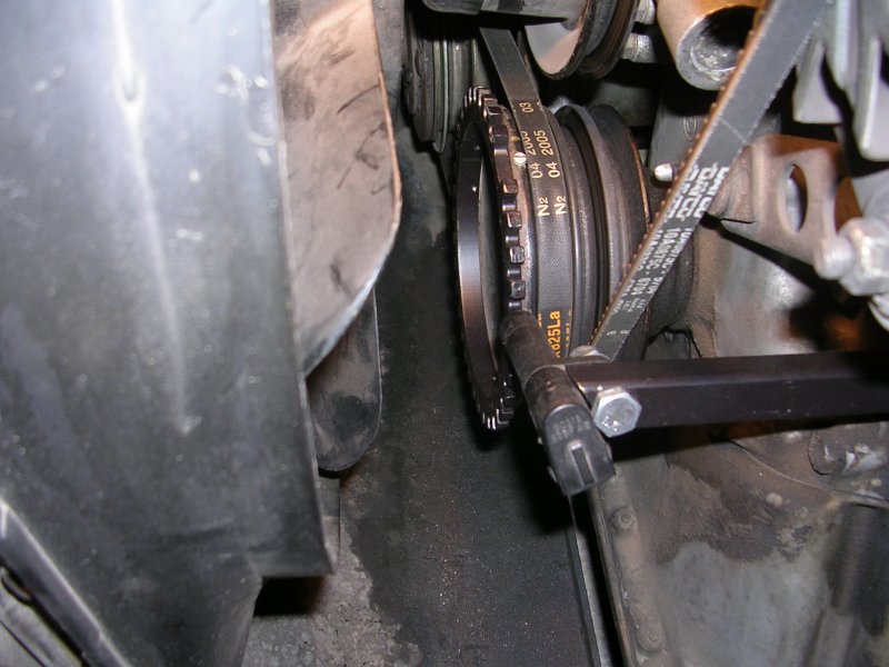

...  mounted on a pulley.

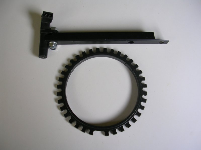

My trigger wheel and VR sensor...

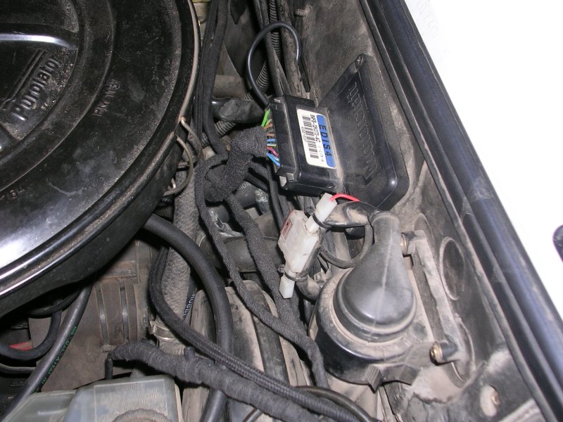

EDIS unit located at the firewall.
I will pull out my distributor and put coil pack in it's place, but for now it is located like this.

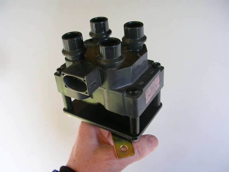

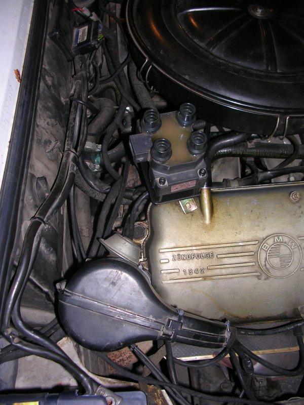

Coil pack mounted on the bracket.

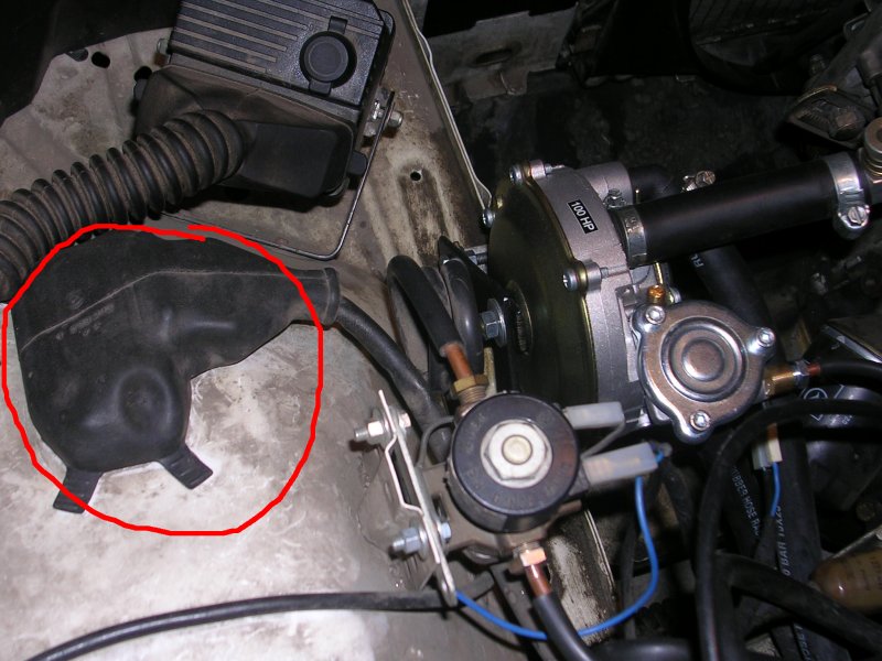

My old ignition ECU, and on the right you can see few parts of LPG system.

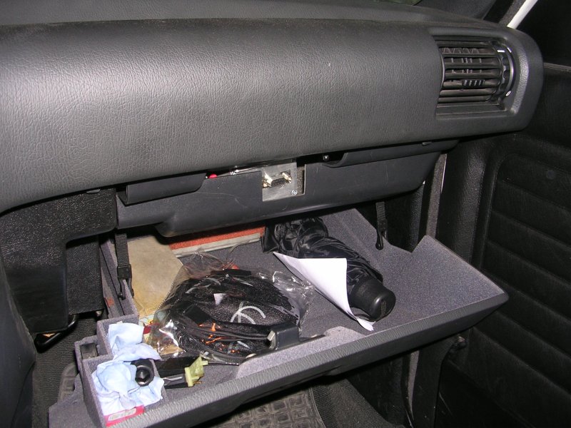

I fitted MJLJ at the place where BMW originally fitted fuel injection ECU which gave me easy access to serial port.

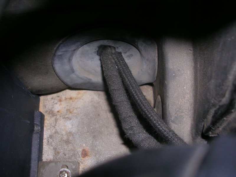

Wiring loom and vacuum hose enters cabin.
