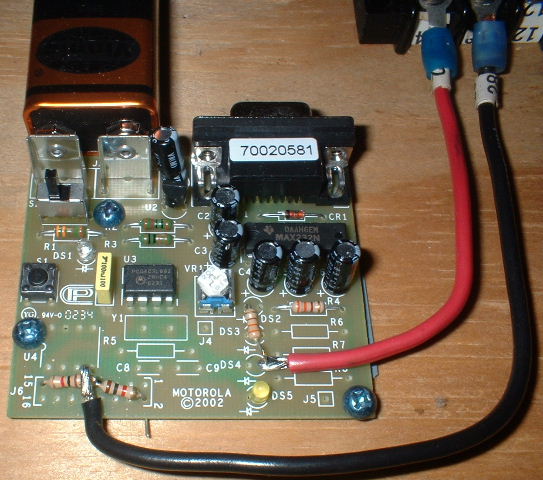

In attachment a picture of the board I'm using to program the grippo vr simulator.

When you load the original VR-Stimulator onto this board, what problems do you have? The stimulator has one input- the speed control, plus one output, simulating the trigger wheel sensor. Since there are only 8 pins on the QT4 device, it should be straightforward to compare the original schematic against what is on the board you have. you may need to modify the board slightly to achieve your goal.

I got the message that the code isn't valid for the 908qt4.
I even asked a friend who does this kind of stuff as a research engineer and he got the same problem.
I only use the demo board for programming.I have another pcb on which I put the ic after programming.
