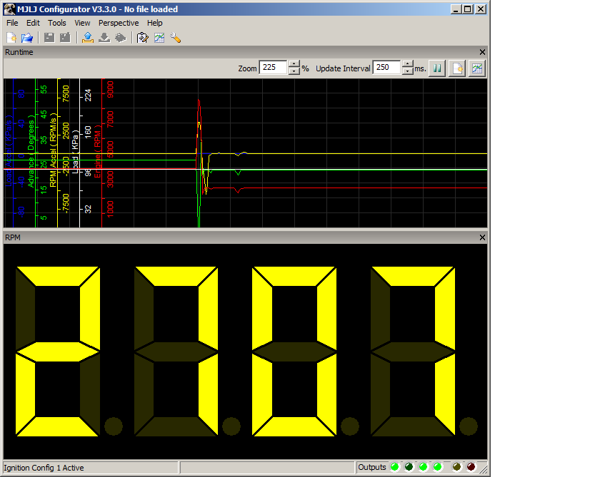

However, the next version of the configuration software will allow RPM and/or load to be viewed as a large digital display, in case you were interested
In the picture, the upper part of the screen can be minimized as well..
http://www.autosportlabs.net/asl_dist/m ... cation.pdf
- config_sw_large_rpm_numbers.png (43.78 KiB) Viewed 5049 times
