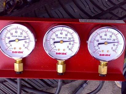

This has meant the carbs are now much happier to balence, as the fatter spark and altered ignition timing allow for sync-ing of the carbs to be better achieved.

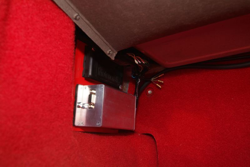

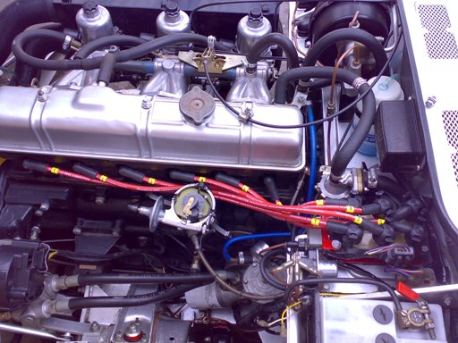

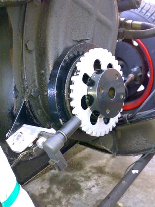

A few pics of the install. Coil pack on scuttle. Old dizzy only in situ 'til the tacho is sorted. Mondeo 24v supplied the parts required, timing wheel machined to fit onto Triumph crank boss. Then th MJLU and EDIS unit mounted on a seperate plate in the passenger footwell.

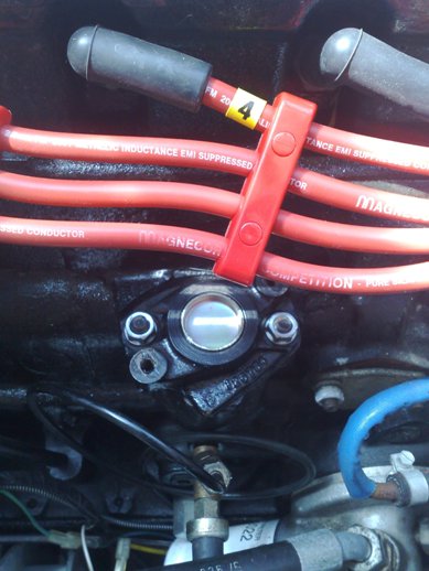

If you go for an electronic tacho as well, Chris Witor has had a blanking plug made to fill the hole including the dizy pedestal.
Just shim as before to set the end float on the oil pump / dizy drive gear.
The're not cheap but it does tidy up the engine bay!!

Hi Simon. I used someone else's idea and fitted a core plug into the dizzy pedestal! :D
