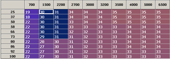

Engine Mfg:Austin
Engine Code:12h
Cylinders:4
Displacement (cc):1310
Rev Limit:7000
TPS or MAP:MAP
Boosted or Normally Aspirated:NA
Modifications:
Hedworx Ported head 35mm intake/ 29mm ex CR 10.5:1
CalverST CST 3010 RE13 profile 276deg 290 lobe lift. 104.5 LCA timed at 106 degrees
Minispares 1.56 forged rockers
Maniflow stainless freeflow exhaust manifold 1.75 inch into SS twin box RC40.
MG metro intake
HIF 44 w. CalverST ultimate filterkit. modified float valve to 2,5mm diameter vs 1.8mm (otherwise the float bowl is drained at WOT)
Pierburg electric fuel pump w. Malapasi Fuel regulator
NGK BP7ES
Chassis: Mini
Notes: preliminary map not yet dyno'd

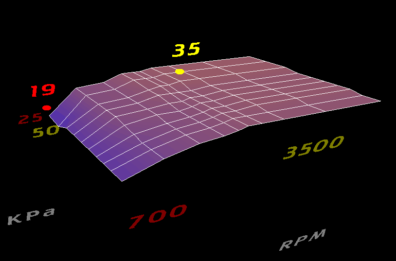

all advance in very very quickly
RE13 development map 3.mjlj
(719 Bytes) Downloaded 1415 times
Mini 1310-RE13 cam
Hi, been using your map on my car as we have a similar spec and it runs quite well, wondered if you have a more up-to-date version which you are running currently
