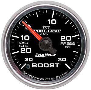

can you explain the reasoning for having the vacuum gauge going anti-clockwise (towards low numbers) for high vac?

Hi John,
The gauge reads in absolute pressure. Higher pressure, the more the needle moves clockwise.
Since the unit can read boost from forced induction applications, the gauge needle moves backwards for vacuum, and forward for boost. Much like the real boost gauges you might see.
In Normally Aspirated mode the gauge is simply scaled from 103-0 KPa.
Are there any real-world gauges that move clockwise for more vacuum? Emulating what people would expect to see would be good- obviously reduces surprises and requires less 'explaining'.

Thanks Brent,
I had not seen an actual vac gauge before!. However the V4 gauge goes anticlockwise and the figures DECREASE (from 102 to zero), rather than increase (0 to 30 Hg) as per your examples.....although I notice they are both in Hg!! (see my previous old post

The gauge in the software shows absolute pressure, in KPa, so it's an inverted concept from inches of Mercury. Smaller number, less pressure (higher vacuum). So if the physical gauge shown here were in Metric KPa, the values would decrease in an anti-clockwise manner as well.
