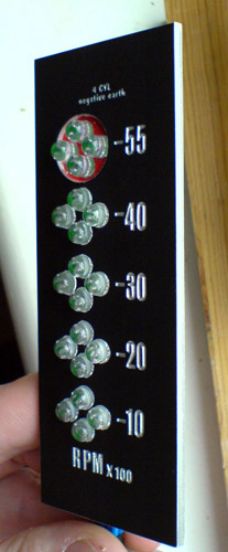

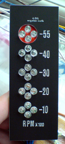

Sequential LED panel for dashboard - design based on a Smiths rev counter (to match the other gauges on the dashboard), CNC engraved by Brian Herridge @ Orchard engineering ([email protected]):

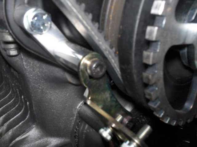

The SC trigger wheel was eventually replaced with a MED machined pulley, solving the clearance problems and I've been running the MJ with a basic map for several months now with no problems.
