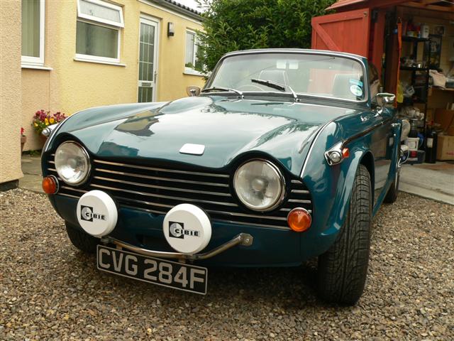

The end of a 10 year (intermittant) restoration.....
P1040171 (Small).JPG (79.31 KiB) Viewed 13946 times

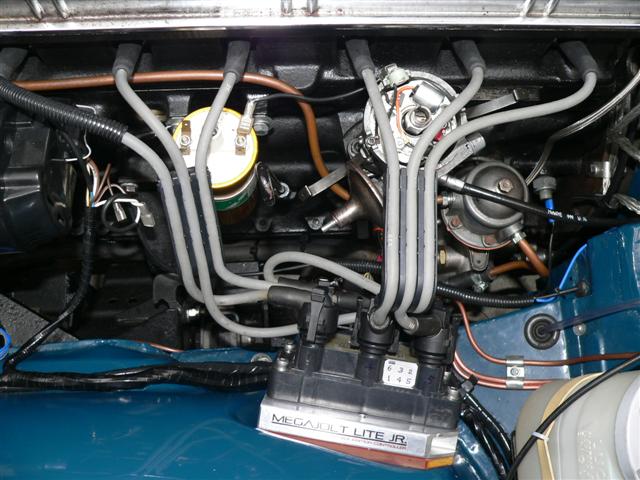

V6 Mondeo coil pack mounted on inner wing....old coil and dizzy must go!
P1040155 (Small).JPG (69.12 KiB) Viewed 13970 times

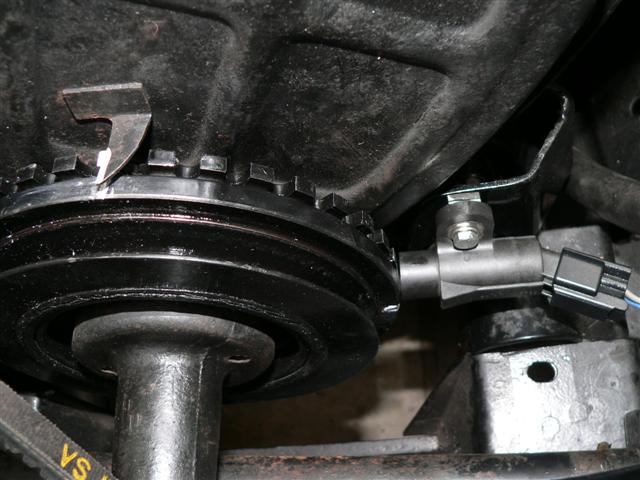

Trigger wheels.com ring wheel fitted to machined rear of cast iron pulley and rebalanced
P1040146 (Small).JPG (55.82 KiB) Viewed 13972 times

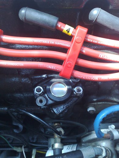

My GT6 dizzy made the supreme sacrifice and I merely popped a core plug in its place. You can get specific dizzy pedestals for his purpose from Chris Witor if you want to though.
Small core plug.jpg (46.1 KiB) Viewed 13900 times
