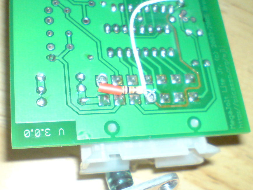

I have been using the MAP switch without a ground for Map 1 however i have an issue with changing the outputs in Map1, thinking this could be the reason i want to add the ground to the input for Map 1.
I have a single pole switch and do not really want to use a relay and the switch is perfect in the dash, so can anyone confirm that if a put a 10k resistor between the input and 0v (as shown in the picture) will this work.
Please ignore the wire replacing the track this was due to a previous error where i put 12v with out the 1k resistor onto the input :oops: An experience i do not want to repeat hence the question.
10k resistor.JPG (101.78 KiB) Viewed 10850 times

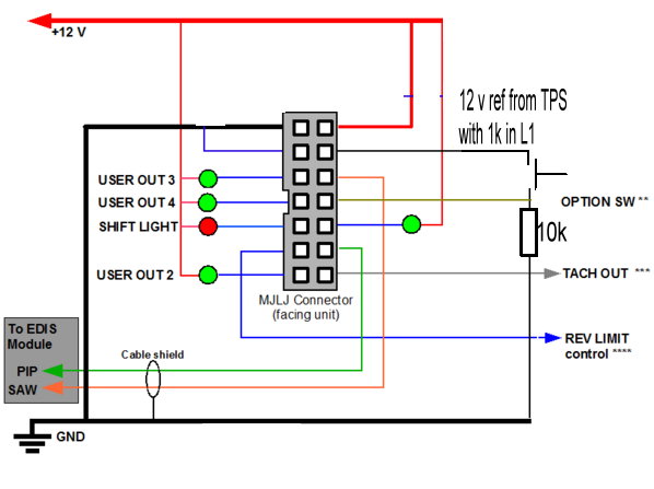

I have used the 12v from the TPS ref pin by putting a 1K resistor in L1.
I think my theory will work but wanted a second opinion before causing too much damage :lol:
10k resistor1.JPG (47.34 KiB) Viewed 10833 times

I can now confirm that installing a 10k resistor between the option switch and 0V allows you to use a single pole switch :lol:
