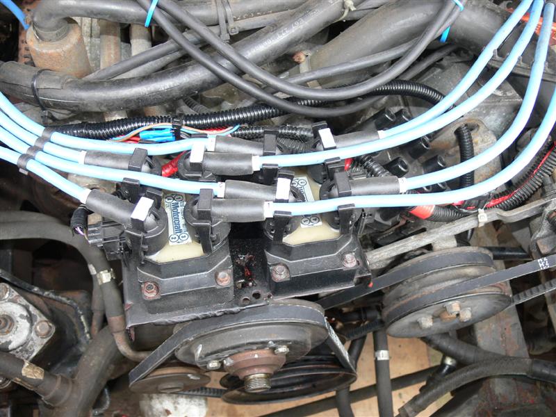

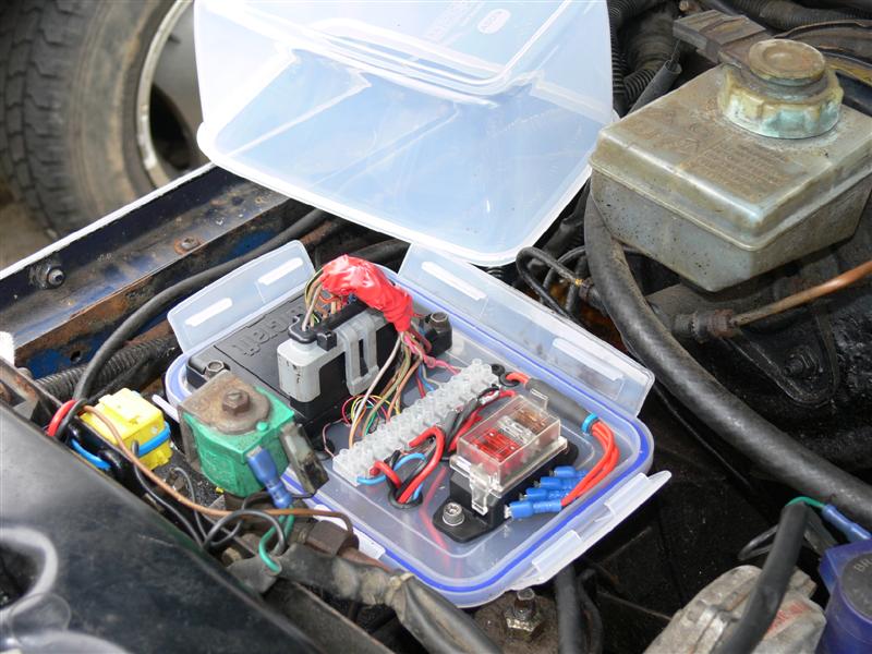

EDIS wiring: As you can see I take a belt and braces approach to water resistance since, although the EDIS components are waterproof, my wiring is not ;)
Plug leads using the fairly commmon Range Rover mounting position on top of the water pump.

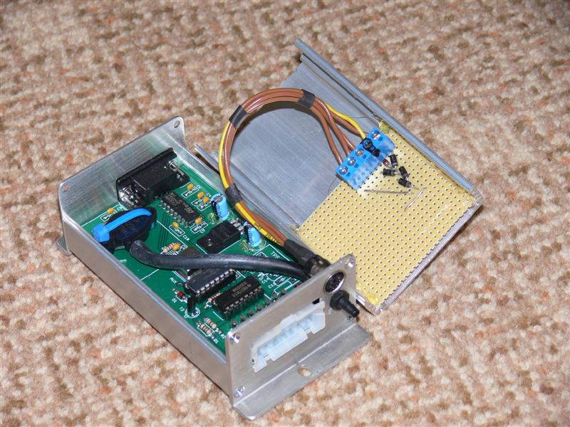

Megajolt!<br />Showing the setup I have for triggering tach-in on the EFI ECU. <br />You might be able to see it uses a PS/2 plug and is the &amp;quot;4 diodes and a zenner&amp;quot; circuit. The lead back to the coil wires is a PS/2 extension (Maplins) and is shielded
Megajolt!
You might be able to see it uses a PS/2 plug and is the &quot;4 diodes and a zenner&quot; circuit. The lead back to the coil wires is a PS/2 extension (Maplins) and is shielded

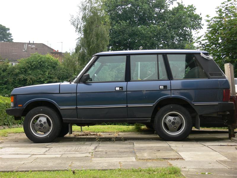

And here she is four years ago before I started ripping her apart.
Jobs done so far:
I have welded the front, the drivers side, the rear and the chassis.
I have replaced the ignition, plugs, leads, fuel tank, fuel pipes and the upper tailgate.
I have removed the rear seats and relocated the LPG tank to just behind the front seats, replacing and relocating the filler and pipework while I was at it.
Still to do:
Weld the passenger side and the rear floor, service/replace the brakes as required and fit electric fans.
Nearly there!
:D
&amp;quot;The Old Girl&amp;quot;
&quot;The Old Girl&quot;
Range Rover.JPG (101.34 KiB) Viewed 34863 times
