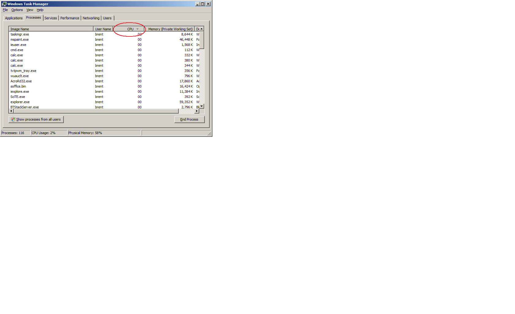

See the attached- sort CPU usage from high to low, this puts the apps consuming the most CPU at the top of the list.
So far hard to say why it's running slow on your machine. Do you have another machine, with similar capabilities you can try it on?
Do all of your other apps run fast enough?
