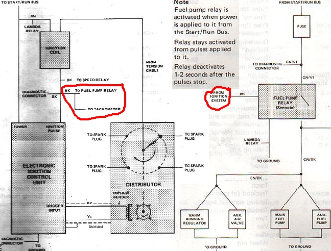

Is the fuel pump running? If not, it's probably because the fuel pump relay will only enable the pump when it sees ignition pulses. This is a safety feature, as it stops high pressure fuel from being pumped out of a split hose (e.g. after an accident).

By what I can see, the fuel pump relay does indeed need a tach input.
Looks like you should be able to disconnect the wire from the relay that goes to the ignition and connect it to the tach out of MJ.

If the tacho out of the Megajolt wont do it, you could try the PIP signal out of the EDIS

Junk the Tachymetric relay (that all K-jet cars use to run the fuel pump) and use a cheap, standard 12V relay. The relay can be feed a permanent 12v into pin 86, pin 85 connected to a user programmable output on the ECU, and the software set to trigger the output a 500rpm - as long as the enigne's at idle or faster the relay is closed and the pump is fed. If the engine dies, the pump shuts down, just as with the original setup.
If 500rpm is too high and wont run the pump to allow the enigine to start, fit a momentary push-to-close switch between relay pin 85 and ground, so you push the button and turn the key - hiding the push-button might make a handy immobliser too ;)

Gilesy, I like that idea, just add a second relay(or second trigger for the first) off of the starter position so the pump runs during cranking also. Problem should go away then I would think.

I have had a similar problem with a LH jetronic, the version with the electronics all in the MAF, this sistem takes the tach signal from the original coil but using a wasted spark coil arrangement with the MJLJ and EDIS the problem is give the correct signal, without the bosch system don't work. I have solved the problem with a little ciruit using a pullup resistor and two diodes connected to the 2 signals of the coil A abd B. Usually, the signal for the LH-Jetronic is HIGH but when the EDIS give the ground signal at each coil, the signal for the jetronic goes to LOW state and the system works properly. I dont know if your jetronic works like mines, but if do you want, i can post a schematic diagram.
