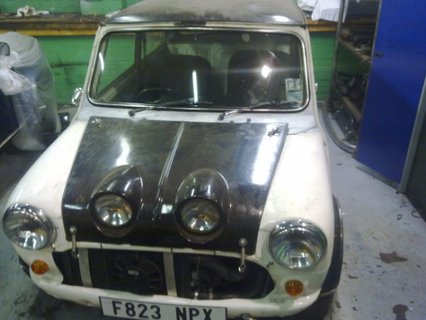

- How she looks at the mo, give me a shout if you like or dislike the bonnet lights
- 24102008306 (855 x 642).jpg (141.06 KiB) Viewed 35321 times

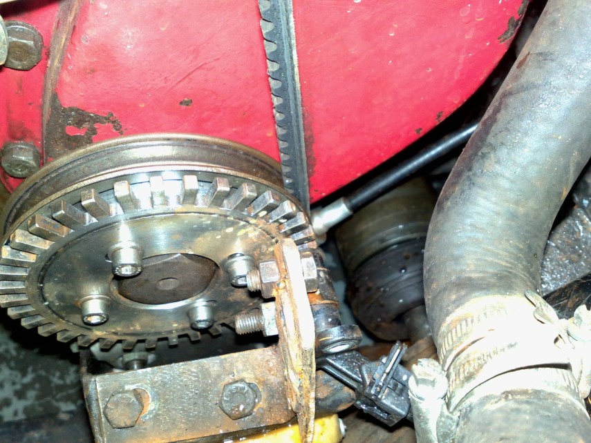

- trigger wheel and vr sensor mounting
- 17102008251 (855 x 642).jpg (164.53 KiB) Viewed 35321 times

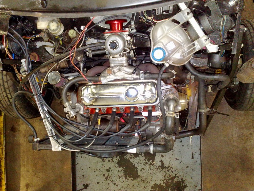

- engine from above
- 23102008293 (855 x 642).jpg (199.86 KiB) Viewed 35326 times

Now THAT is a Trigger Wheel

I prefered to mount my VR sensor this way as all the brackets i'd seen always look to flimsy, plus any sideways vibration wouldn't alter the signal produced. The VR bracket is recycled from the old radiator bracket.

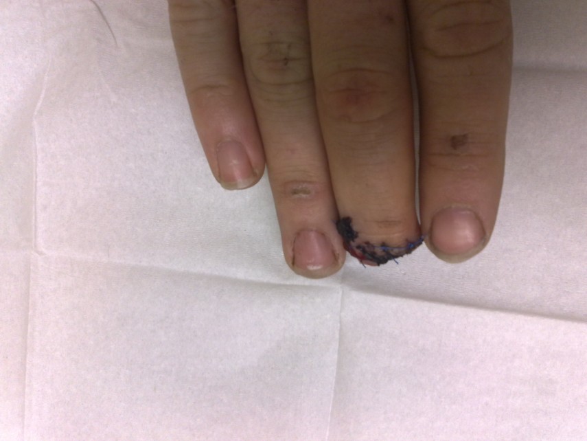

- Part of what the build has cost me, lol - Others Beware, don't stick your hand near a running engine
- 02102008137 (855 x 642).jpg (78.74 KiB) Viewed 35298 times

commiserations about the finger, and looking it, i am hopeful that it wont interfere too much with the purposes to which one puts ones hands. at the risk of being macabre, may i ask about the other bit of it? ie was medical help to attach it not available in time, or was it too damaged to do so?
some years back i gave one of my thumbs a very nasty slice with a knife, and while it was getting better from the ensuing surgery, i found that at surprisingly large number of men have had a bad hand injury at some point. it was a real eye opener as to the numerous ways in which they can be cut, broken, or severed.

oh man, i was hoping you may have just been playing the severed finger trick on us. my condolences on the missing part
i learned not to take my hands for granted after
1. getting 2nd & 3rd degree burns from a conveyor belt at FedEx
2. going a head and cutting out one more tread on the routing table when i knew i was already tired
no more stupidity for this time (so that's my plan though).

It was quite funny at the time i did it, thought i just took the nail off but looking at it i found it a bit shorter. You should of seen the other lads faces working in the workshop, a picture i tell you.
Well its safe to say i have learned my lesson and have a bit more respect for all things mechanical.
The other bit of my finger is in my tool box at the moment, finger nail and all. I couldn't get it at the time of going to hopsital but my mates had great fun recovering it, they really did, and sending me a phot of it.
Oh well live and learn

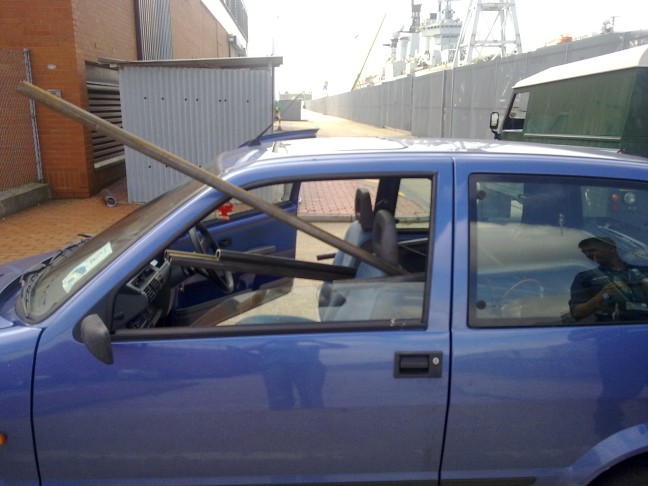

- My little cinquecento full of roll cage steel bent and cut to size. Anyone for jousting????
- Rollcage.jpg (68.23 KiB) Viewed 33409 times

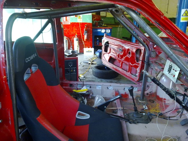

- Metro with some of the cage fitted.
- Rollcage fitting.jpg (107.48 KiB) Viewed 33409 times

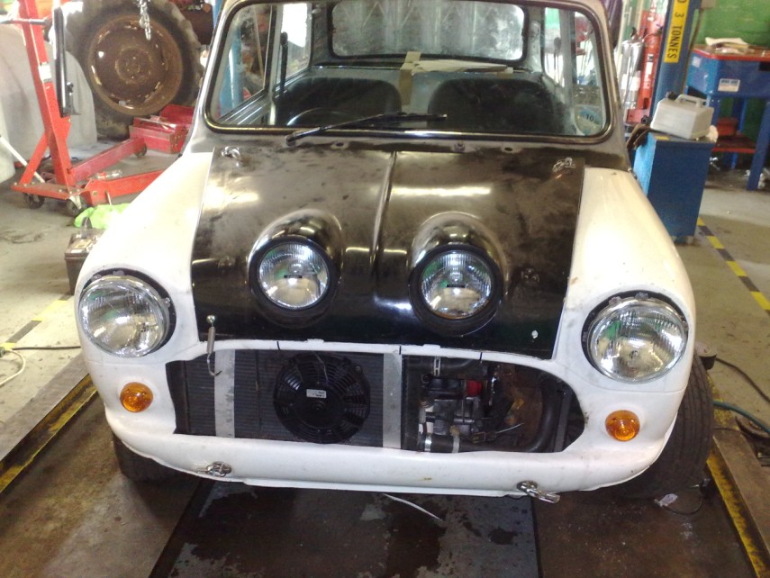

- Side view
- 09112009 Mini.jpg (59.35 KiB) Viewed 32472 times
- Another front view, with new euro style ali number plate and arches back on
- 09112009419 mini.jpg (58.53 KiB) Viewed 32472 times

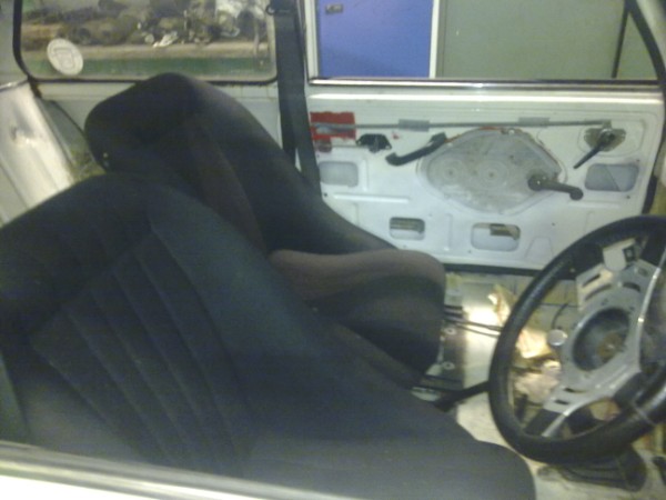

- I love these seats. I call them back breakers as they have no head rests. I believe they fit well with the design of the car.
- 09112009420 mini.jpg (47.44 KiB) Viewed 32472 times

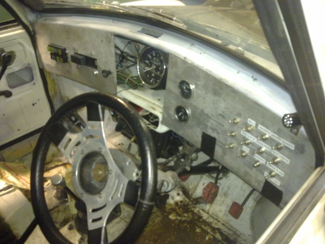

And my home made dash.
As you can see mostly unfinished, but it has only been 3 years since she was off the road so i have done quite well??
I guess i'd better stop doing other peoples cars now.
- My homemade dash with switches from maplin £3 each and about 12 of them, little overkill i know.
- 09112009421 mini.jpg (73.14 KiB) Viewed 32469 times
