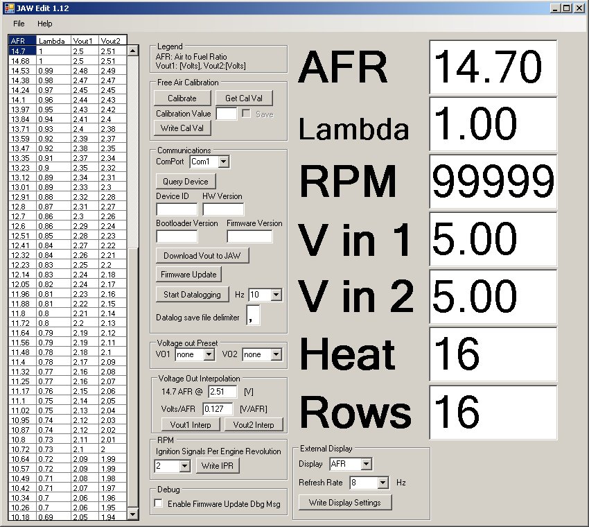

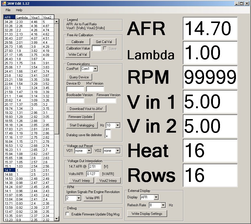

I have attached screen shots from my WBO2 so you can see the variables I have to work with. Note that I can slide the scale and change the # of vols per AFR for Bout #2 (where I will get the signal form the WBO2 for the MJ)

- WBO2-low.jpg (163.63 KiB) Viewed 6514 times
- WBO2-high.jpg (163.85 KiB) Viewed 6514 times
