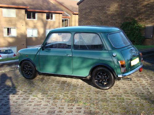

My project;
Started off as a 1990 Racing Green. I finished two years worth of rebuild in January 2008; now starting on a Megajolt installation in preparation for a new engine and gearbox this year.
Standard 998cc A+
All steel flip front
Minisport Adjustaride suspension kit
Safety Devices six point rollcage
Cobra Clubman driver's seat with Securon four point harness
Momo Model 69 steering wheel
KAD Mk2 Quickshift
Complete rewire with home-made 18 fuse wiring loom

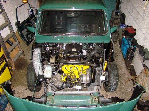

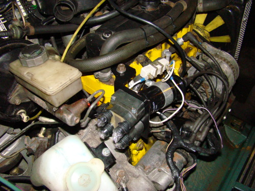

Congested engine bay - it's got both coils and the distributor on there at the moment.

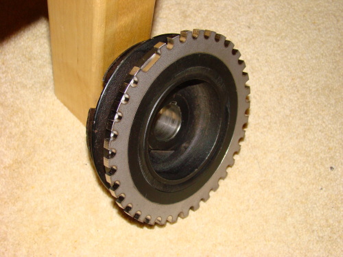

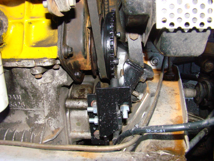

Trigger wheel mounted on the standard crank damper/pulley

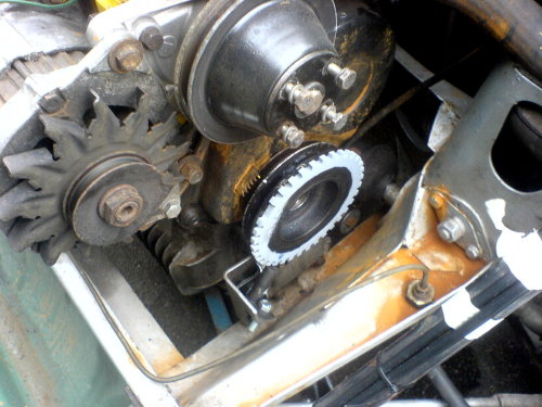

Trigger wheel and sensor in place

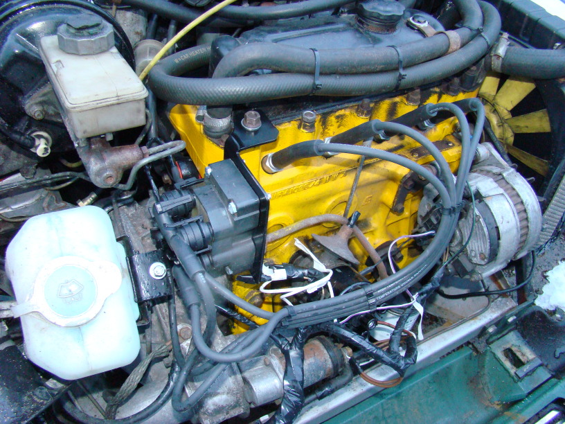

Trigger wheel and sensor arrangement
