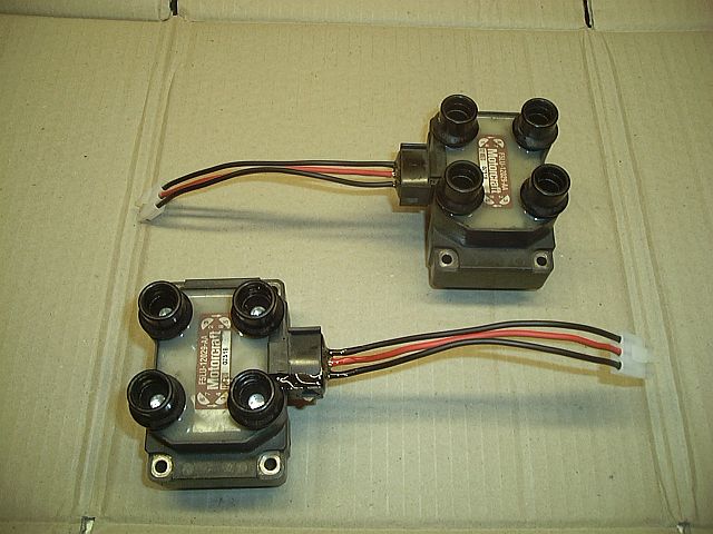

i gather that new connectors for the ford coil packs are expensive for what they are. i bought 2 coil pack in oz for the installation i am just completing, and neglected to even ask if they came with connectors. which they did not. so i bought small size spade connectors, crimped wire into them, put them on the coil terminals, then filled the cavity with expoxy glue. cheap and effective!

That's brilliant! nice way to replace them with cheap and effective molex connectors!

And you could use auto grade waterproof connectors too. Genius, and if you use that uber-flexible silicone-sheathed cable, it's a further-ruggedised coilpack connector!
