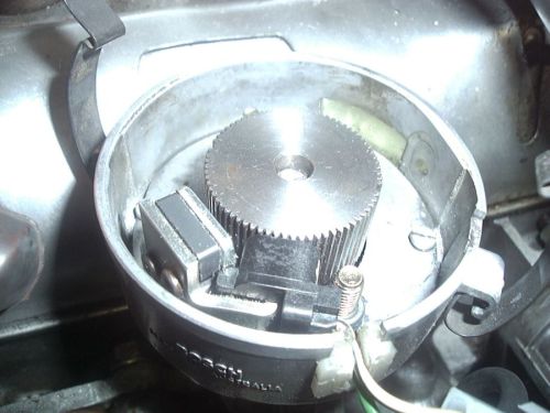

just re recap on previous discussions, this is my installation using that sensor:
that trigger wheel is 35mm across ie about 1.5", so there is a benchmark for smallness.
there is a little runout, but <1mm: enough to see as varying signal strength on an oscilloscope
but it works perfectly.

dean, a couple of photos. first, you can see the thickness of my wheel. it is in fact thicker
than the VR sensor by a good margin. perhaps you could try buying a second, identical
spur gear, and gluing, screwing or tacking them together to increase the thickness of yours,
so the total thickness is at least the same as the metal strip on the sensore (about 10mm)?
the other photo is almost directly above. there is only about 1mm between the sensor
and wheel, with <1mm runout. it works fine. i have never revved the motor much over
6000rpm.

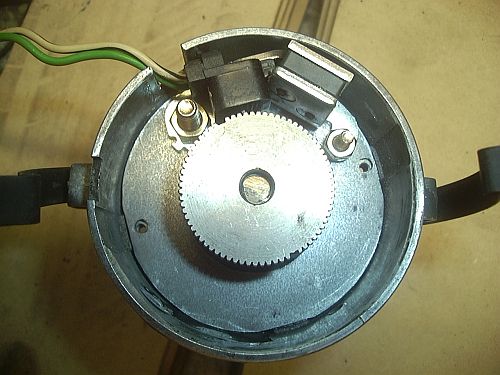

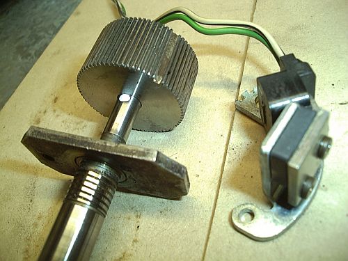

Ok I decided to look at how the VR sensor in the RX7 is actually spaced from the trigger wheel in its housing as well as what the size of the trigger wheel is.
Points of interest. The trigger wheel is .395" thick (.375= 3/8")
The sensor pickup is .314" wide
The sensor is approximately .010" from the trigger wheel :shock: :shock:
The diameter of the trigger wheel is 1.340"
So for starters my .250" (1/4" wide trigger wheel is two narrow. I am now sure that it is what is causing the miss and the degraded performance. I need to go to a minimum of .395" thick trigger wheel. 7/16= .4375" but reality is that I will probably have to go to .500" (1/2") as the 3/8 would be under what the Mazda engineers did. I could probably get away with it but alignment of the sensor to the trigger wheel would be critical. you would have about .061" to play with. Not a real problem but I would prefer to build in the tolerances that Mazda did to ensure that it works as designed.
Here are a bunch of photos I took of the sensors in there housing as used on the FC RX7

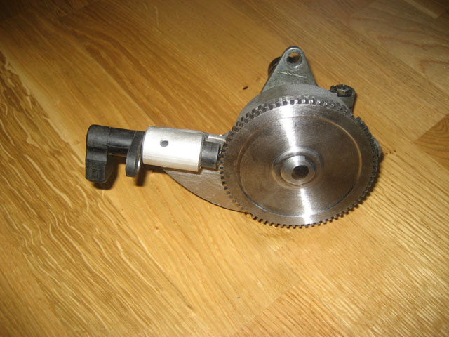

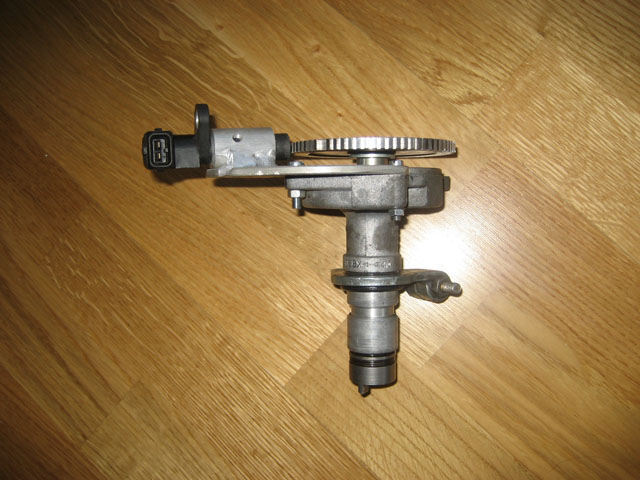

I had a 72-2 wheel manufactured. I first tried with a stock Ford VR-sensor. But it wouldn't trigger properly. Causing only sporadic sparks.
I then tried with a RX-7 sensor that Alexander kindly provided me with. That worked fine.
Haven't really run the car much after, it turned out the engine was in very poor state. I got the car to start and run. But since the engine has been dismantled, and is being rebuilt now.
Here are images of my two versions of sensor with the same wheel.
So, it seems the wheel you see in the picture at least is to small for Ford sensor. (to rule out how small the wheels can be)
Patriq
Posts: 161
Location: Oslo, Norway
Post by Patriq »
second image
