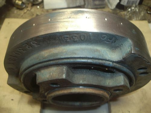

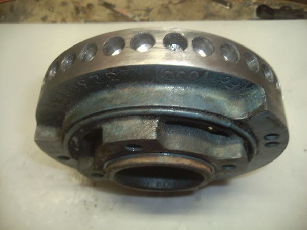

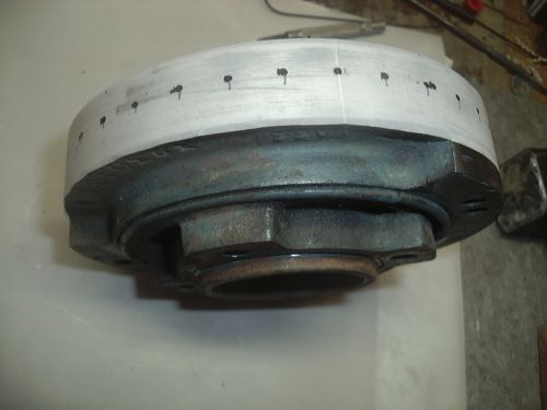

this is the harmonic balancer (from an AMC 360 V8 ), drilled to create a trigger wheel. as noted above, this idea is from another contributor on this, list several months ago. without looking up just now whom it was, i will just say a big thanks to him for a really clever idea!
as the photos indicate, i wrapped a piece of paper around the balancer, then cut it so it was exactly one circumference long. then i folde the paper in 4. then i measured and marked each quarter into 9 divisions. then wrapped the paper back around, held it on with sticky tape, and marked each pen mark with the centre punch. an hour on the drill press later, and presto!
- PANA0022 - small.jpg (38.61 KiB) Viewed 18705 times
- PANA0021 - small.jpg (34.71 KiB) Viewed 18705 times
- PANA0020 - small.jpg (27.26 KiB) Viewed 18709 times

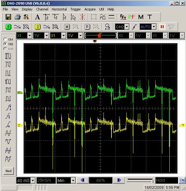

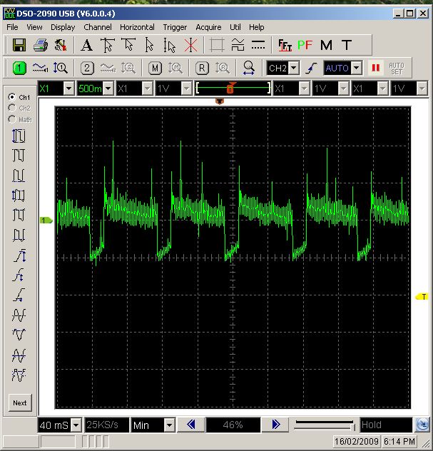

ok well, i have now put the probes on again and get a different pattern now. of course.
the odd +ve swing from one of the coil triggers is gone, but it still shows A & D, and B & C, triggering at the same time. which confirms the fact that i could see both the letters "A" and "D", and "B" and "C" at the same time with the strobe lightl.
note that the +ve voltage spike in the middle of the low voltage part of each wave form only appears when i have both the probes connected to the supply wire at the same time.
- a&d second try.jpg (89.17 KiB) Viewed 18619 times

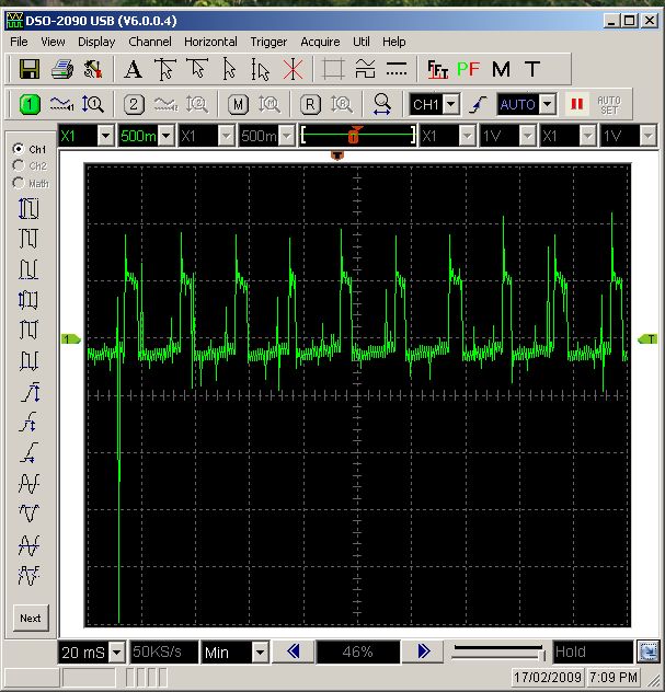

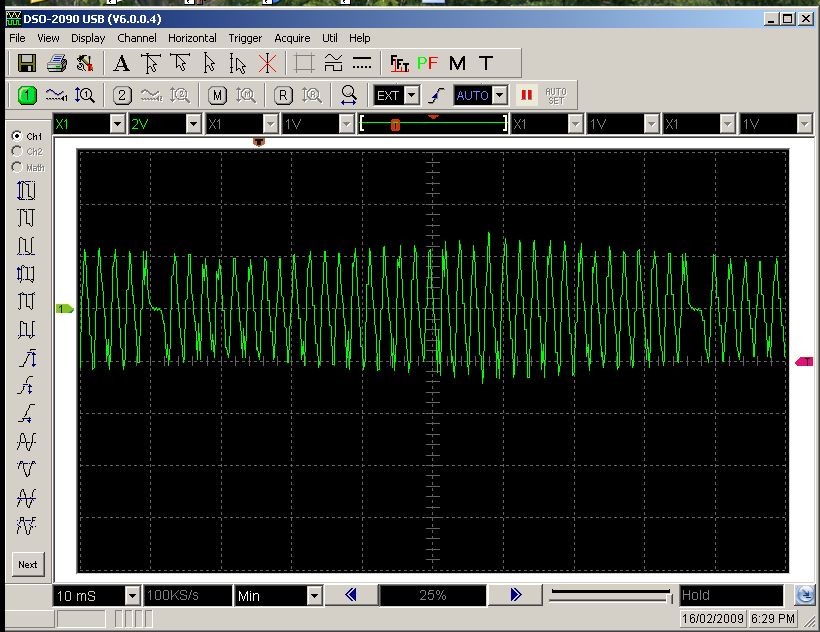

for the record, a couple more images..
firstly, the VR output waveform, looking exactly as it should; and
secondly, the output of just one of the coil trigger wires, showing a much cleaner waveform than the earlier images. that is with only one probe attached ie not trying to measure both trigger signals simultaneously, and it is amazing how much of difference it made to the cleanness of the signal, NOT having the wires going to the scope, lying across one of the spark plug leads
- VR waveform.jpeg (105.81 KiB) Viewed 18616 times
- B only.jpg (84.62 KiB) Viewed 18616 times
Your scope isn't plotting right to left is it?
If not your sensor output is wrong, which could be confusing things. The falling edge should drop straight down, then it will return towards the midpoint as the sensor sees the "flat" at the bottom of the missing tooth, then finally spike back up on the rising edge. Something like this:
to take the image of the VR waveform i have unplugged the harness at the VR sensor and attached the scope wires, so the fact that the important part of it is in reverse is simply that i had the probes on 'backwards'. the VR is however connected into the harness the right way - one way around the EDIS didnt trigger at all, the other way it does.
