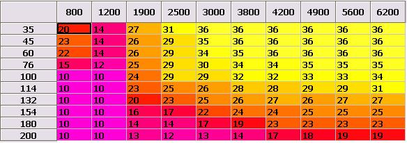

I have attached my current map, we have increased the off boost advance to try and tune the problem out.. I might try some copper pipe around the dashpot to the heater pipes to see if this helps..

Hmm, dashpot ? I assume we're talking about some sort of SU or Stromberg carb then ?
I dont have any experience with them, other than the knowledge they work via a venturi vacuum driven needle/piston designed to keep a relatively constant velocity through the carb. Supercharged huh.. I assume its a draw-through setup ?
Do you have an EGO sensor on the exhaust ? Monitoring that is always a good idea for a supercharged car, since lean outs can rapidly become catastrophic.
If you put a wideband EGO sensor in and hook it up the Aux input on the MJ then you can log the A/F ratio while you drive, and see if its a deceleration leanout that is causing your stall. Rolling Roads often dont show up that sort of thing.
Freezing the carb doesnt sound likely, but like I Said I have no hands on experience with SU's, so maybe its more common than I know. I assume you're in the UK and things are probably a bit colder than I am used to in Australia.
Are you watching the fuel pressure ? Acceleration based fuel starvation is another thing that wont show on a RR (No G forces), although I doubt it would only show on return to idle - unless the carbs idle circuit is more sensitive to float levels (do they have a float ?) than the main circuit.
How about fatenning the up the idle until it barely runs from richness, then go for a drive. If the stall doesnt happen or is harder to make happen, then you know for sure its a fuel dry-out problem.
On a conventional carb, you could just pump the accelerator pump a couple of times on deceleration to keep things wet and prove the cause, but I dont think SU's have a pump do they ?
Assuming it is a dry-out, that could be tricky to fix. you probably need to set the throttle plates idle position open more to keep air moving through enough to keep the needle flowing fuel.. no doubt that would stuff the idle speed up though.
If you can confirm the cause, might be time to call for an SU guru's help. Constant Velocity Carbs are weird things to us Weber-Heads
