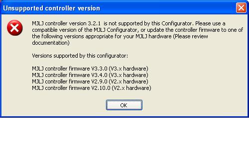

as I've had progress one step at a time,gaining spark was my last achievement on my 1,8 pinto'd Sierra. And now,downloading the correct firmware was another hurdle (as picture below),but now sorted.

Hi Paul,
I take it you downloaded the 3.2.1 configuration software which got you past the error message?

brentp wrote:Hi Paul,
I did a search which led me to this topic http://www.autosportlabs.org/viewtopic. ... da51c722a7
And that put me right
