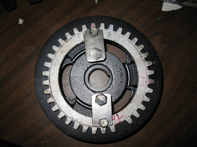

I've searched all over and can't find a specification for air gap.
I have the thick crank sensor unit with the short magnetic sensor...from a Taurus maybe? not sure..
anyway, I was thinking maybe a credit card?
Ryan
pic of my trigger wheel and caveman-like attachment!
1 mm or 0.040" is about perfect. Make sure there is no runout on your trigger wheel.
