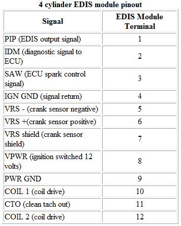

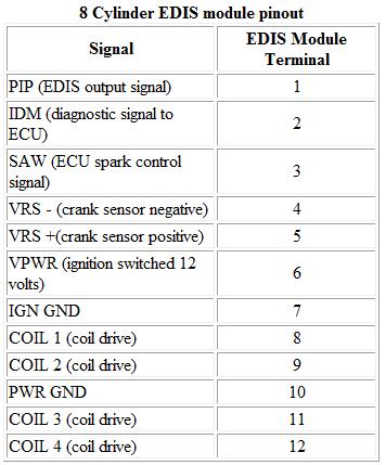

cng1 wrote:EDIS-4 and EDIS-8 use different connectors.
They are different connectors, it's shape, but the pins are the same. I was suggesting you take the pins out of the EDIS4 plug and put them into the EDIS8 plug. This way you nealy have a complete loom with screened cable and grounds etc. You only need to add the cables for coils 3 & 4.
I've attached the two plug connections to make the swap easy.
