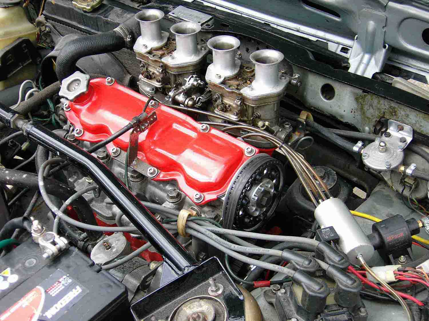

This is the 127 1301cc engine bay of my test car.More images to follow.

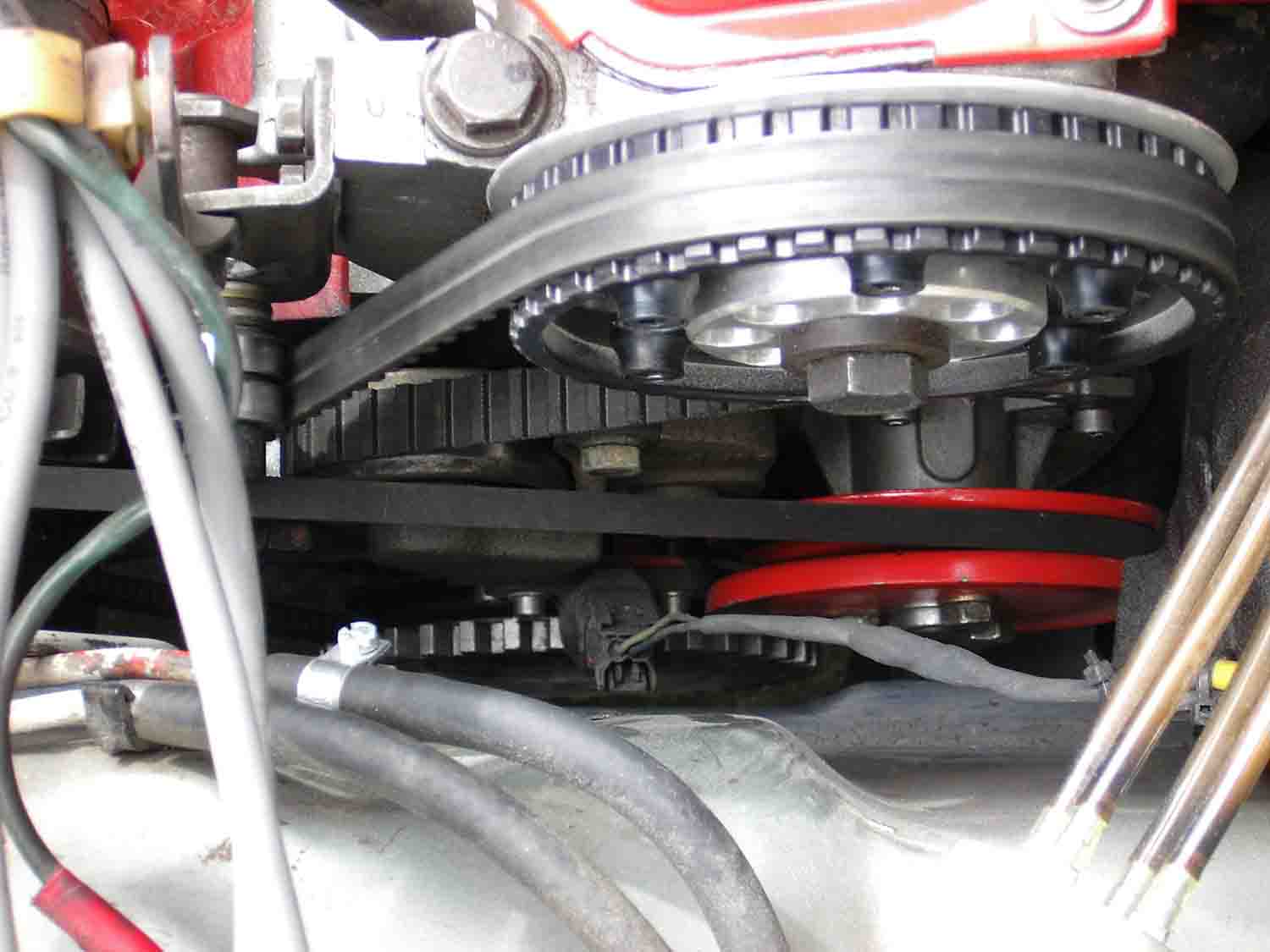

more detail
Post by jeffrey 127 »
more detail
