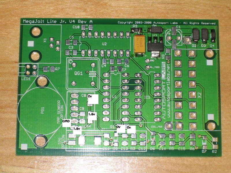

mattwynn
Posts: 6
Joined: Mon Aug 15, 2005 11:34 am
Post by mattwynn »
Next installment!
I'm showing approx 1.5 v between pin 6 and ground dropping down to approx 0.5 v by sucking on the pipe. no increase when blow! also getting the same drop between ground pin 5 and R4 but no reading at all between ground andthe far side of C8! and nothing at R1.
does this make sense to anyone?
thanks
Matt
