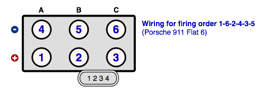

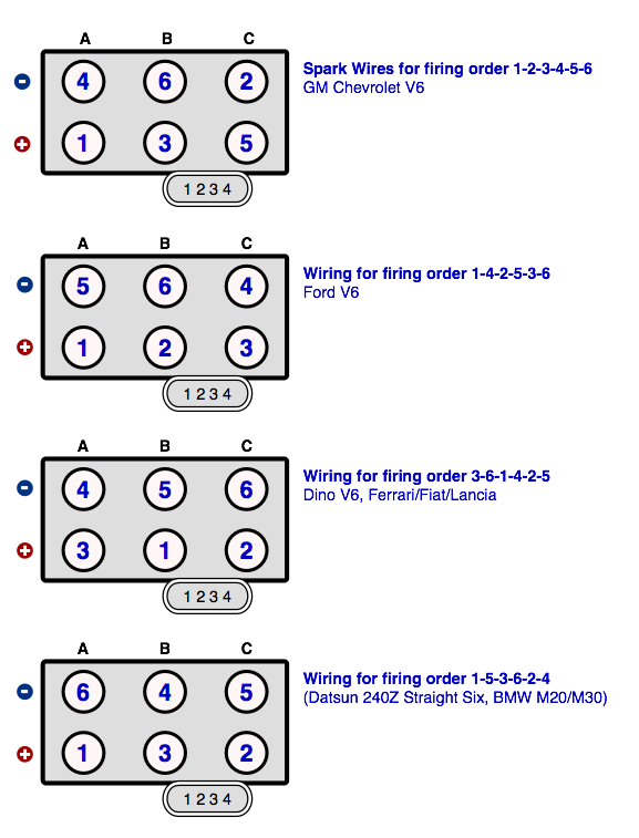

after being confused for a little while i seem to have worked out the spark wire order for the EDIS6 coil pack. Assuming that others installing an EDIS6 coil pack might encounter the same issues, i have put some firing orders in a table below, hope it helps. Let me know if anything is wrong.
The EDIS6 coil pack contains three independent coils where the winding of each coil is tapped in the middle, basically creating six coil circuits (EDIT: the coils are not tapped, see chart in the next posts). The upper three coil terminals have a negative polarity, the lower three terminals are positive. I have assigned each bank to the positive or negative terminals, respectively used an even/odd assignment for the straight six example.

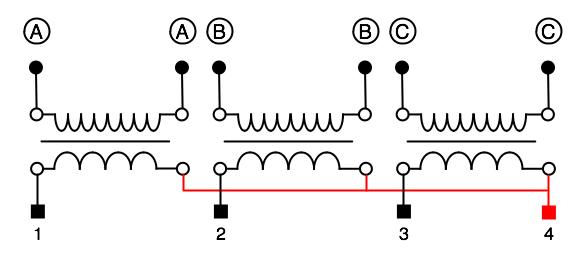

adrian, i will stand to be corrected on this, but i dont think the above description of the EDIS coils is correct.
in, say, an EDIS6 coil, there are 3 separate primary, and 3 associated secondary coils. each primary is connected to the common 12v input, and is individually earthed by the EDIS at the apppropriate moment. i dont think there are centre tapped, and i dont think there are effectively 6 coils. it is only 3. each primary induces a larger voltage signal in the associated secondary, and that coil is not connected to anything other than the two HT outputs. the current path is through the secondary, out one terminal through one spark plug, through the engine metal, through the other spark plug and lead, and back into the coil. yes, there is +ve and -ve in that HT path, but it is of no consequence which way around the plugs, in any particular pair, are connected to the coils. pardon moi if you only meant to assign them that way as a matter of convenience for connection. that doesnt make anything you said incorrect practically speaking; but i think the strict truth of the matter is just a little more general.
that, at any rate, is my understanding of the coil construction and connection.

Alexander,
you are fully correct, thanks for noticing. I was assuming that each secondary coil has a ground connection as in a standard single coil, but as you stated this is not the case for EDIS coil packs. The chart of the coils internal below should be correct.
Best,
Adrian
Best,
Adrian
- edis6_scheme.png (21.78 KiB) Viewed 65385 times

We also need 1-6-2-4-3-5 for a Porsche 911 flat 6

lads, may the good lord strike me on the temple, with a bosch GT40 coil, if i am wrong, but i do think it is as i stated.
if you put a multimeter on the any pair of plug sockets on the coil, i believe you will find they are connected to each other, and that they are not connected to the low voltage pins at all. that is because they are the opposite ends of the HT coil. the voltage is induced in it just as the voltage is induced in the secondary of an ac power transformer. this is quite different to the construction of your old style coil.
i believe it is as depicted in adrian's graphic, which plainly shows the secondaries as not connected to the ground.
perhaps we are slightly as crossed purpose: when i say there are 3 primary coils and 3 secondaries, i am not referring to the number of turns in the coils, if that is how it reads. there is of course a ratio of something like 1:20 between the coils in the primary and the coils in the secondary.
regards
alexander.
regards
alexander.

Figuring out the correct coil wiring for *any* engine is fairly simple if you understand how the EDIS waste-spark works.
The Edis simply fires the coil outputs in order from TDC#1 over and over again.
If its an Edis-4, its just AB, AB, AB,
if its an EDIS-6, ACB, ACB, ACB *** Note unusual firing order for Edis-6, NOT ABC !!
If its an EDIS-8, ABCD, ABCD, ABCD
etc.
when I say "Fire", I mean releases the grounding for that coil, which as mentioned collapses the field and triggers the two plugs attached to that coil.
So what you want to do is when coil A fires, you want one end of it to be the cylinder that should currently be firing, and the other end (wasted spark) of it to be the one that is on the opposite side of the firing order (which will be TDC (minus advance) on the Exhaust Stroke)
So, the trick to remembering how to work it out is... you split the firing order in half and sit the two halves above each other with the coil pairs as headings... so for my engine (a Hemi 6) with a firing order of 1,5,3,6,2,4 then we go like this..
A,C,B (**Note unusual Edis-6 ACB Order)
1,5,3
6,2,4
so in this case...
Coil A goes to 1 and 6,
Coil B goes to 5 and 2,
Coil C goes to 3 and 4
Lets throw another example for an EDIS-8
- Chev small Block, Firing Order is 1,8,4,3,6,5,7,2
A,B,C,D
1,8,4,3
6,5,7,2
Coil A is 1 & 6
Coil B is 8 & 5
Coil C is 4 & 7
Coil D is 3 & 2
and Edis 4 is the same as Edis8, but obviously just the first two, AB, AB etc.
Does that make it clear ? If you can get your head around that, then figuring out any engines correct plug wiring for EDIS is a snap.

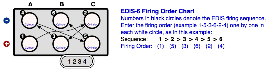

EDIS6 DIY Chart
I did a little do it yourself chart to document the spark plug wiring. If you have the fire order for your engine (as example 1-5-3-6-2-4) you just fill in each cylinder of the fire order in the sequence on the chart - presto!
If that works for you guys i could do the same with the EDIS-4 and EDIS-8 setup.
