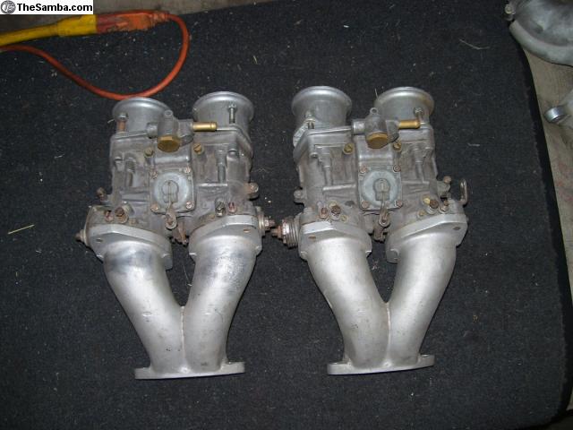

I currently have a single port which I'm replacing with dual port heads, and it's going to have dual webers. I have no problem modifying the intake with a barb, I just wanted to make sure that was the correct procedure. With dual carbs do I need to tape off both intakes and run it into a collector, or will one side be Ok?

Hey Nitro, thanks for the response. The attached file is the type of intakes I'll be running, it'll have dual carbs. I believe most people that use these type of carbs use a mechanical advance distributor instead of a vacuum advance.
