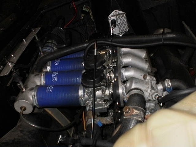

Well I guess a bit of an update - the headgasket needed doing! So while the head was off it had new guides, seats and valves cut and lapped, a skim - and a bigger cam.
I also pulled all the megajolt out and moved the edis inside the car - along with hiding all the front end loom and moving the battery and washer etc.
I'm still playing with tweaking the mj now and fuelling etc - I can't believe the amount of fuel it wants at the top end - i'm currently on 2mm jets and it will still take more!
Anyway what the bay looks like now:
I don't have any up to date pics of the interior yet - I will take some showing the shift lights, edis mounting etc.

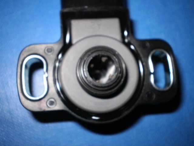

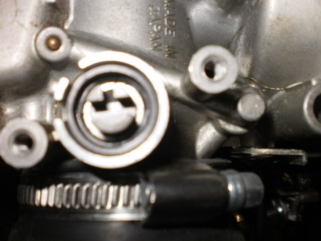

Hi, I have a setup that looks like your's. I also like to install a MegaJolt. Now i am bussy collecting the parts i need. I bought a TPS for the Mikuni's. I think i bought the wrong one, do you have a part number of you're TPS for reference?
ps
TPS has 4 notches, Mikuni's have a sort of two half circle's one of them has a opening
