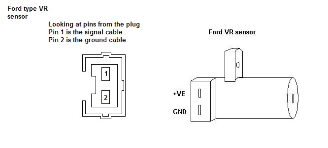

Anyone know which pin is the positive side, Can't see an obvious mark anywhere !

After an extensive Google session I stumbled on this !

OK I've to the local U-pull it this morning and relived a HCS Fiesta of its complete EDIS system and according to the EDIS 4 pin out and the Ford wiring colours the above diagram is wrong !
I wired up my EDIS8 with the VR sensor the same way around as the cannibalised EDIS4.
If it don't work at least I know where to start looking !

Ooops just realised i'm looking into the wrong side of the connector, found another drawing that states "viewed looking into the harness" so i've transposed pin 1 & pin12. Looks like I'll be busy with the soldering iron again this week.B@man wrote:OK I've to the local U-pull it this morning and relived a HCS Fiesta of its complete EDIS system and according to the EDIS 4 pin out and the Ford wiring colours the above diagram is wrong !

Holly smokes batman i think you have hit it on the head!!!!! Kapow
I'll double check my circuit when i can get to it tomorrow to confirm for you. Well done for the research and looks like quite a handy diagram.
Don't worry, you're not alone - it's a very easy thing to get mixed up over.B@man wrote: Ooops just realised i'm looking into the wrong side of the connector, found another drawing that states "viewed looking into the harness" so i've transposed pin 1 & pin12. Looks like I'll be busy with the soldering iron again this week.

The industry I work in always refers to the plug as you look into the equipment whereas all the EDIS stuff appears to be looking the other way from the equipment into the loom, at least this explains why things where so confusing !

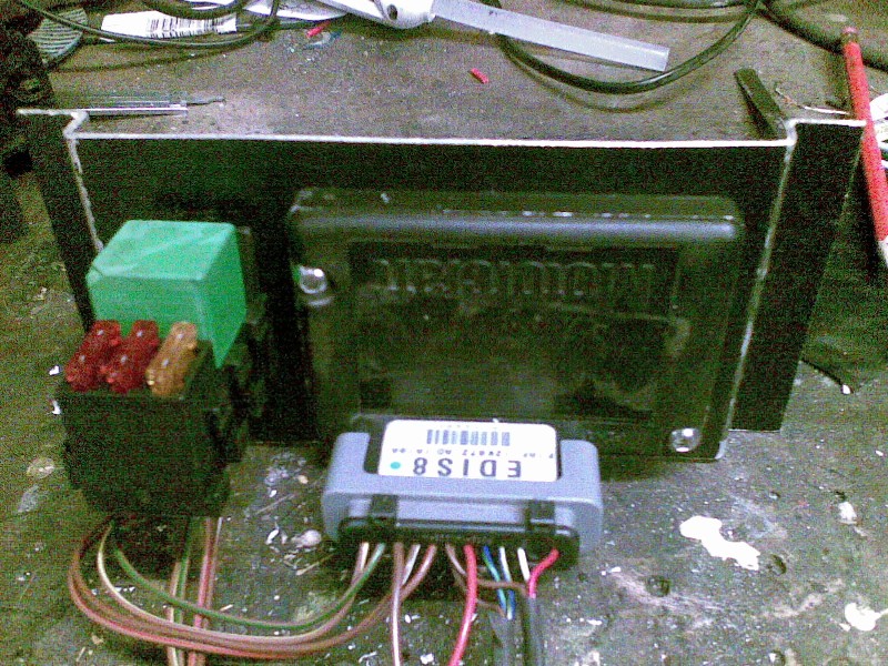

Got there at last.
The EDIS8 drawing on the B&G site is a little less confusing than the one on the MJ install instructions as the keyways are shown correctly, that combined with a photograph of Elliots EDIS8 wiring from mez.co.uk meant not even I could go wrong.
Here is the result (cra**y phone cam but you get the idea)
The green "relay" is now a box for 4 diodes to live in to trigger the OEM tacho and Lucas "flapper" injection ECU (Hopefully) it Still needs a little paint before fitting, but I'm making progress.
