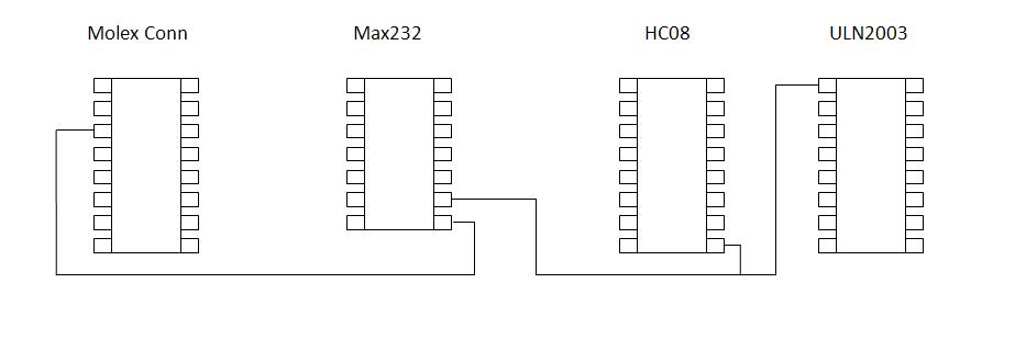

What i would do now is take off the casing for the controller but connect it to the car and have the engine running. The PIP signal comes onto the board through the molex connector, into the max 232 at pin 8, out of the max 232 through pin 9 then splits in 2 directions, one to hc08 processor pin 9 and pin 1 of the uln2003. I have included a pic to show how the PIP line is connected through the circuit board. This should help with fault finding on the PIP line.

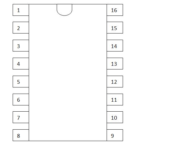

I have also included a second pic of how the pins are numbered on all chips. If there are more than 16 pins then it still follows the same format.

Ryan is on the right track for tracing the signal from the Molex connector all the way to the processor chip. The equivalent signal travels from the molex connector, through the MAX232A chip, and on to the processor. Verifying the signal gets to the processor is key. Once it does, it will show an RPM signal.

Thanks to you NITROPIXIE we have solved the problem. It was the line you said it would be. The soldered joint between MAX 232 and the other two chips. Tested this with multi meter and nothing. Basically heated up the solder again and tested it and now everything works fine.
