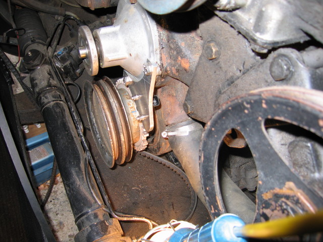

The VR sensor mount picks up the water pump mounting bolts.  The commonly used VR sensor with cranked end connection did not fit so I used one from an Australian EF Falcon with straight connection.  I bored the 36-1 wheel for heat shrinking onto the back
VR sensor mount.JPG (118.1 KiB) Viewed 15705 times

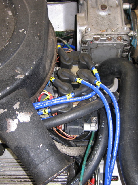

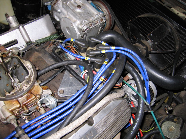

The coil pack mount is made from 6mm Aluminium and bolts to the original coil mounts on the inlet manifold.  A cheap 2nd hand distributor was cut down to fit under the coil packs and is required to retain the oil pump drive shaft in position.
The EDIS module is mounted on a bracket forward of the radiator mounts away from the prodigious engine bay heat.  The MJLJ is mounted in the glove box.

I got the tach working with the MJLJ output using Theo Smits conversion board. The movement in the Jensen tach has a lower resistance than the one in the Sunbeam Tigers that his design was based on so he did a modified board for me which worked well.
I didn't have any belt alignment problems because the position of the crank pully was not altered. I simply bored the Ford trigger wheel for a shrink fit on the 'body' of the pressed metal pulley. I put the pulley in the lathe to true it up but it was exceedingly true for a pressed metal item and only needed the merest skim to clean it up. I heated the trigger wheel up with the oxy and dropped it onto the pulley and ended up with a really good strong shrink fit.
