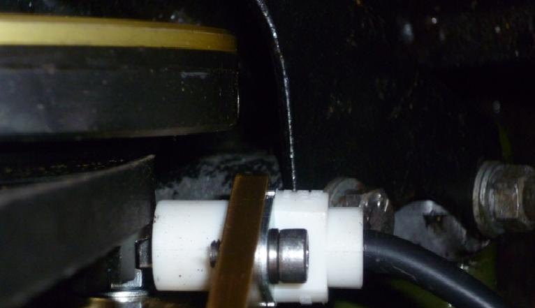

I have one other question I am using a magnetimarelli VR sensor I have had a timing light across the plugs on limp mode and the timeing seems to be a little unstable. I think this may be the battery which I am taking to get checked today (Voltage seems a little low). But has anybody used the MED sensor mount and wheel see picture. Not entirely sure that the sensor is in the correct position as the centerline is not exactly over the teeth and mesuring the AC across it when cranking it gives about 0.8VAC to 0.9VAC Any Ideas do I need to correct the alignment and machine the pillars down or is this ok ? It seems to fire the plugs ok in limp mode ok also I have tryed taking the plugs out and the VR sensor gives about 1.2VAC when freely turning over.

Have this afternoon wired up a relay and taken a feed from the solonoid. I believe haveing hooked up an oscilscope to the VR sensor that it is working fine.
