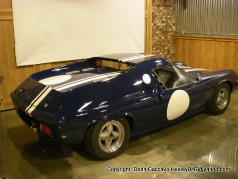

First drive after 6 years of slow restoration.

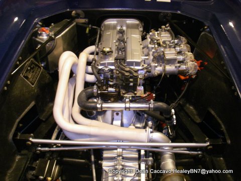

2.0L Black top Zetec (2001 Focus)
45 DCOE carbs
Wilwood 4 corner disk brakes
Wilwood hanging 5:1 pedals
47 Style side windows/dash/side vents/fuel filler
Revolution wheels -R888 tires
Independent rear upper link suspension
Adjustable AVOs
Original gauges; tach works!

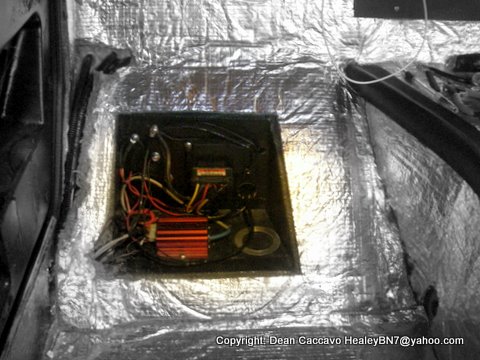

MegaJolt/EDIS is located behind the front passenger seat
