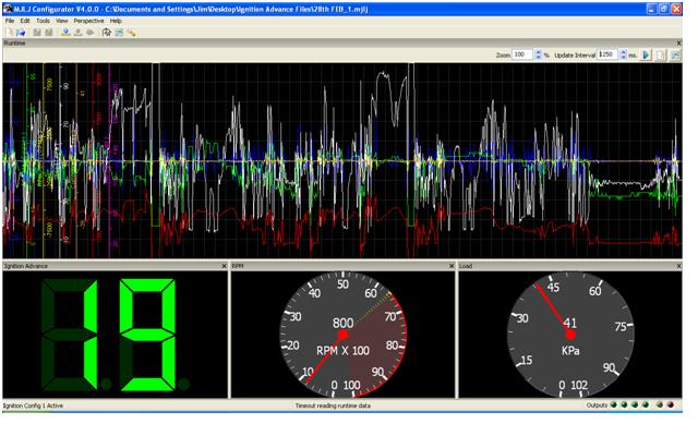

Ok so this evening I have tryed a few things. I tryed retarding all values in the spi2 map by 5 deg. Very little or no difference made to uphill power. Then tryed takeing raw map and just bumping up a few of the advance figures round the high load area to make it flatter. This made a little difference to the uphill power. Decided to finally try the RE13 map this made no difference. Thierfore have come to conclusion that the problem not advance related. I suspect it is probably more to do with something else. Have attached a picture of the datalog for this evening two uphill sections with spi2 +5deg (Starts around pink vertical line) and RE13 (Starts around half way extends to right) maps can be seen each uphill run can be seen ending with REVS droping red line to zero. Delibrately stoped engine to mark the spot.

Does it look fueling related ?

We really need to know what needles in the carb, with that sort of spec i'd be trying the BDL maybe the BDD. Have a look what's in there and report back.

The Needle is BER (Was this standard out of factory for minis ?) but I think someone has been at it with a file. The spring I am pritty sure is standard red. No paint left could test it at work but will leave it till next monday as they said they have a selection of parts for SU carbs. I have a copy of winSU now so I am going to see what that recommends.
toenee
Posts: 75
Joined: Mon Aug 31, 2009 6:46 pm
Post by toenee »
That'll be the problem, have you not got a BDL you can try ? Quite a common needle, if you don't have one someone in your local mini club may. So see if you could borrow it for testing purposes.

Ok update. I took the car down to Geraldale on monday. Car was almost running on air as expected. Gerald changed the existing needle and adjusted it to make the fueling safe with current ignition map (SPI2). This has sorted the fueling issue so that I can adjust the advance map without worrying that the fueling is poor. Gerald also gave me some advice on the ignition map. I have now updated the map so that on the flat the advance is correct. Gradually getting closer. As for Rolling road I have found one in crawley who are willing to make the map. However the map I have created so far is very different from where I started off with the SPI2 map. I put the map up for refernce after I get it completed.
