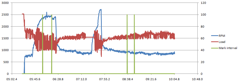

I've just logged a short run of my engine but am very confused about the kPa readings. As expected, when the engine is not running, I get a value of around 100kPa (I've trimmed the zero rpm values from the attached graph). The values then sit at roughly 70kPa but DROP as the rpm increases - this is counter intuitive to me...
A graph of a short static test I logged
Where do you have your MAP sensor connected on your manifold?

I've tee'd into the brake servo feed. Between the T and the servo there is a non-return valve. I've temporarily disconnected the servo and turned the valve around to block it off
I'm using a 2m length of silicone vacuum hose which I would have thought was flexible enough to damp the readings

Your graph there looks entirely normal for a static test. As your revs climb the engine is trying to suck harder against the (almost completely) closed throttle. The harder it is sucking, the more it is throttled the lower the air pressure you get in the manifold.
Your load line is a little spikey. If you want to smooth it out get hold of a baby fuel filter (a 99 pence mini moto filter is fine) to use as a damping champer or alternatively push a MIG welding tip into the vacuum hose to act as a restrictor.

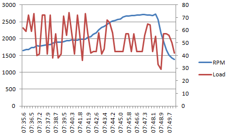

As suggested by Chris, I pushed a mig welding tip into the hose to act as a restrictor. At idle the readings are a little stabilised (I'm going to buy a fuel filter tomorrow to see if that helps) but with increased RPM, they're all over the place again. The flat patch in the middle of the graph is where I squeezed the hose shut for a few seconds.
I also connected a timing gun and ran the engine on EDIS alone. It said my timing was 15 degrees so I corrected that in the software. However, I noticed that the timing gun was saying about 40 degrees when the laptop was showing me 18-20... perhaps it's a crappy timing gun because the engine is starting better than it ever did in the past!
Hopefully I'll be able to take it for a drive later and see what's what.
Static run 2, with mig tip restrictor

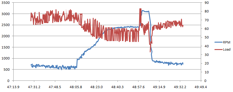

Can you post a zoomed in plot over the course of say 15 seconds of data at higher RPM where it is a bit lumpy? I've an inkling that we're chasing ghosts here so even better would be a plot from a short sample from a real drive where I suspect things will look just fine.

You might be right, Chris, let's hope so. Bit nervous about taking her for a drive as engine bits not easy to access once seats are back in (it's a forward control vehicle) but hopefully putting the distributor back in should be a relativly easy side-of-the-road job once you can see it
Short (15 second) section of plot

That graph is definitely a bit lumpier than I would like but that may just be a symptom of you running the carbs in an area that they wouldn't see in real use and thus delivering a mixture that is a somewhat off.
