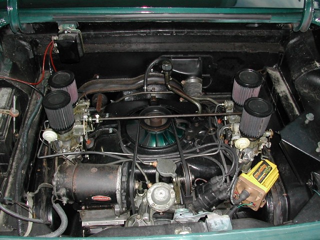

I am installing it on my 1964 Corvair. It has the flat 6, normally aspirated with 4 1bbl carbs. It is actually a 110HP engine with the 4 carb conversion and dual exhaust. My initial goal is to have a complete map for the 140HP engine and also the 110HP engine. I expect my final setting to be some where in between.

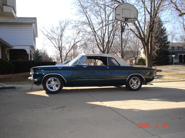

Here is a shot of the car as well as the engine with the Dizzy. I will post after pictures when I am done. I am also removing the mechanical fuel pump and converting to electric.

- 1964 110HP with Otto 4x1 Carb Kit
- 1964Engine.JPG (112.52 KiB) Viewed 24379 times
- 1964 Corvair Monza
- DSC00502.JPG (154.03 KiB) Viewed 24379 times
