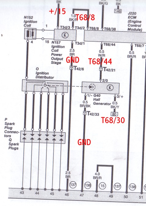

In the attachement there is a electrical diagram from the ignition system on my VR6.
(i am not so familiar with these type of ignition systems so if i ask a stupid question please forgive me)
What i have to find out (i think) is what signals are coming in and out of my ECU, 3 signal in/or out
is what i see on the diagram, i do not know what signals these are. If i look at my tacho i also cannot find out if
it gets his signal from the ECU or somewhere else.

Hi Hendrik,
Carefully read the Megajolt manual. What you intend to do (I think) is replacing the whole ignition part of your engine without touching the injection part (?). Therefore, you will also have to install the Ford EDIS 6 module which will fire the separate coils. The limp home mode is internal to the EDIS module and gives you a fixed advance of 10° before TDC (top dead center) if the Megajolt fails (or other problems with the installation). To make Megajolt work, you need the VR sensor signal and the TPS or MAP signal.
TPS and MAP are two different kinds of the same Megajolt, one fitted with a map-sensor on-board.
After your last post, I get the feeling you haven't read the whole manual. There is a lot of complimentary info to be found on the internet as well, but you have to understand how everything works prior to change your ignition-system. Further on, you want to keep the injection part of your engine, which makes it difficult. The EDIS and the Megajolt modules have tach_out signals which might be compatible for use with your injection-ECU, but you have to find that out for yourself.
The risk of blowing your engine? Isn't this why we all doing that stuff?
