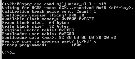

I reinstalled the v3.3.1 firmware on my v3 mjlj to rule out my rough running issue (I use v3.3.2 configurator).
Once the mjlj has been found, I get a different message - 'off key' rather than 'good'. (see attachment)
Will this give an issue, or is it just the way my laptop & mjlj are set up?

Firmware upgrade DOS message
- Not 'good' but 'off key' ?
- v3.3.1 firmware screenshot.jpg (23.51 KiB) Viewed 5220 times

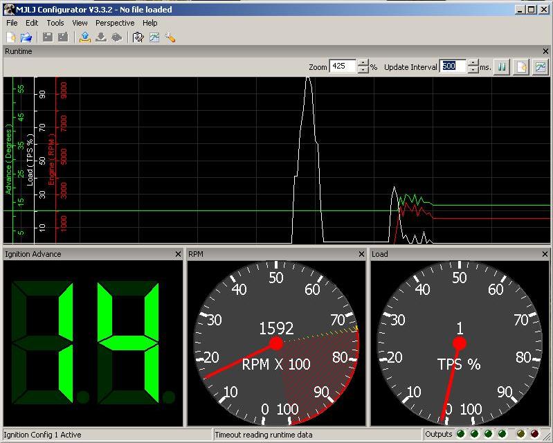

I tried to sort the 'screen freeze when I crank & run the engine' by trying configurator 3.3.1 with my 3.3.1 firmware.
Last time with config 3.3.2 it froze instantly on cranking - this time it worked for a few seconds, then froze.

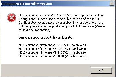

The only way to unfreeze it was to pull the USB plug out, upon which it threw up the Unsupported config version.
Is that what happens when you unplug, or only if there's actually an issue?

- Config timeout upon cranking and running the engine
- Config timeout on engine crank & run.jpg (80.21 KiB) Viewed 5212 times
- What I got when unplugging the usb...
- Pop up after screen freeze then unplugging usb.jpg (25.69 KiB) Viewed 5212 times
