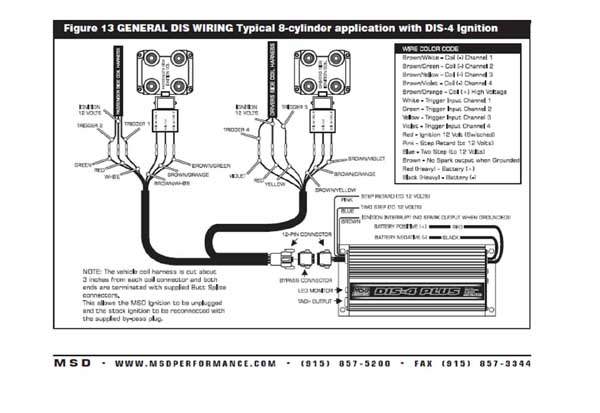

My original question: "Is there any way that the Megajolt running the default MAP could cause this problem?" was a search for another opinion based upon the lack of response from MSD.
In response to your post, I agree; I don't think the MegaJolt is causing the problem.
I would assume, based upon the MSD instruction booklet, that in fact the EDIS Module IS compatible with DIS-4. And it does beg the question why MSD does not have an answer. It may be that the forum techs are not engineers or familiar with their product.
I have attached a copy of the MSD wiring diagram which clearly shows the DIS-4 being triggered from the EDIS module. To me this shows the DIS-4 merely needing an input from the EDIS module.
John
EDIS Wiring.jpg (45.11 KiB) Viewed 27901 times
cng1
Posts: 282
Post by cng1 »
I'm not sure that diagram does show EDIS triggering the MSD DIS as it doesn't show the source of the coil feeds. Those coils on the diagram could just as easily be triggered direct from an ECU or standalone ignition amp.

jcuprisi
Posts: 11
Joined: Sun Jun 17, 2012 12:11 am
Post by jcuprisi »
Although the resolution of the picture is not clear, the two harnessess coming from the top of the page next to each coil are in fact the factory wiring. You can see the actual instructions here from MSD:
http://www.msdignition.com/WorkArea/Dow ... 5032386155
This is a PDF document: Page 12 Diagram 13.
Whether it is a stand alone EDIS Module or Integral EDIS in a factory ECU or an aftermarket ECU the trigger signal goes to the DIS-4 which then triggers the coil.
