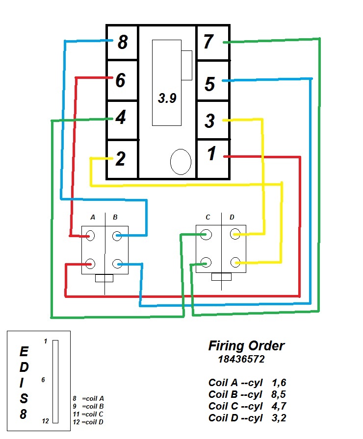

Hi guys, im about to start the process of fitted magejolt to my Landrover Discovery 3.9l V8 serp with a manual box.ive gotten everything i need and will be fitting a megajolt V3.
One thing i havent been able to find anywhere is a definitive coil/cylinder discription. Ive looked n looked lol
Anyways, i think ive got it. Could anyone confirm ive got it wrong or right....fingers crossed ere lol

Did you figure out the wiring order correctly? I

unfortunately i have been delayed fitting the kit. Im due to start it next week so hope its right lol
