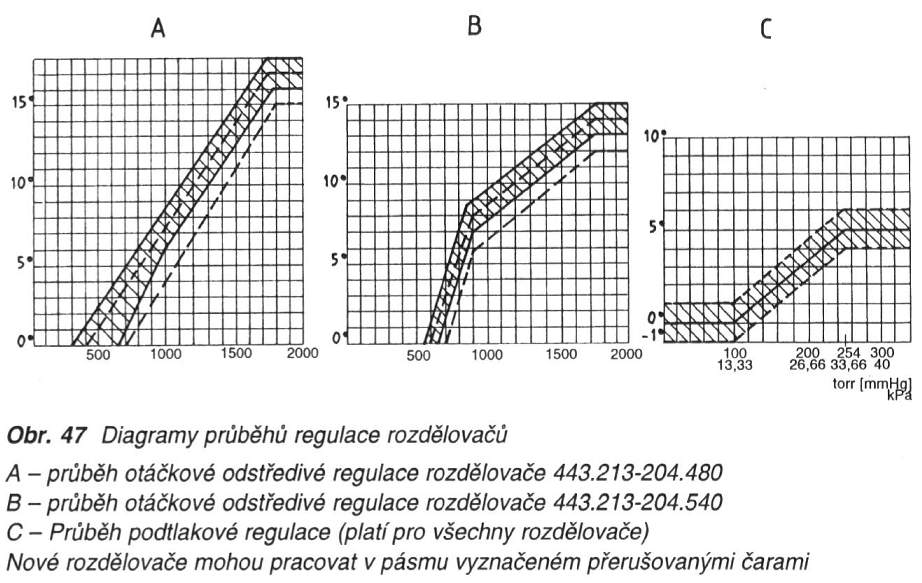

- Here are mechanical and vacuum graphs (B & C) for Skoda distributor (max.3000RPM).
- curbe avans skoda120.jpg (90.47 KiB) Viewed 10014 times

This is coming from a novice when looking at these, but I wonder if these maps are solely for the distributor and are not taking into account for the base timing set when adjusting the distributor itself. If so you could probably throw a few more degrees on the first column of the map in an attempt to match these stock maps, assuming you have a base timing of say 10 degrees.
