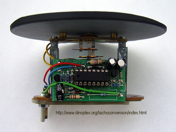

I've deprecated the old attiny based tacho conversion project and created a new one based on standard components. Should be as simple to build as the original one but does not require a programmer or software anymore. The conversion allows you to not only run your original tacho with a megajolt setup but also adapt the tacho for an engine with a cylinder count different from the original one.
http://www.dinoplex.org/tachoconversion/index.html
enjoy,
Adrian
Datsun240Z alh PCB Conversion.jpg (124.11 KiB) Viewed 6209 times

Adrian performed this magic on my Ferrari tach, wonderful job. Worth doing, accuracy is superior.
