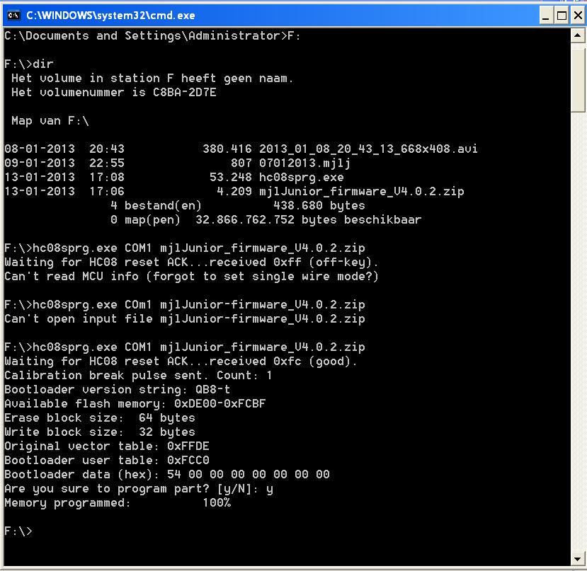

Hi Brent,
Those are the files I used. I tried them again, downloading from scratch and here under are the results.
Is there something I overlook? The mljJunior firmware came as a zip-file. I took the file without using Winzip from the zip-casing and tried that file (the size ± doubled and the extension changed form zip into s19), but that was not successfull either.
Alex
Alex
- 20130113 Megajolt firmware update.JPG (106.37 KiB) Viewed 37782 times
Well, I extracted the zip file with Winzip, I extracted manually, the loadings went largely seen just as the screenshot above, but the result after several attempts is still the same
