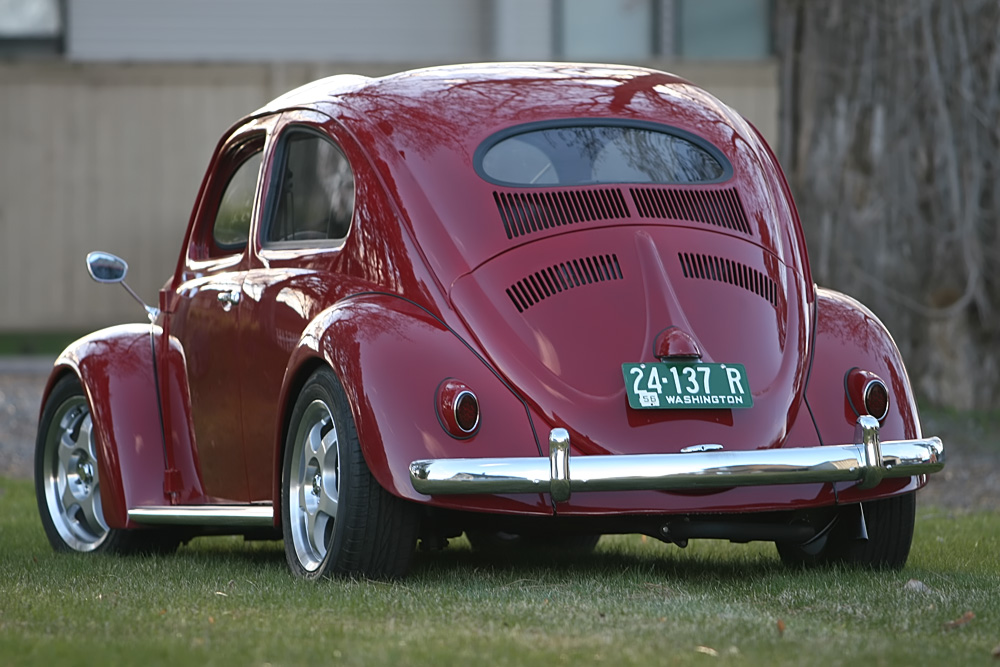

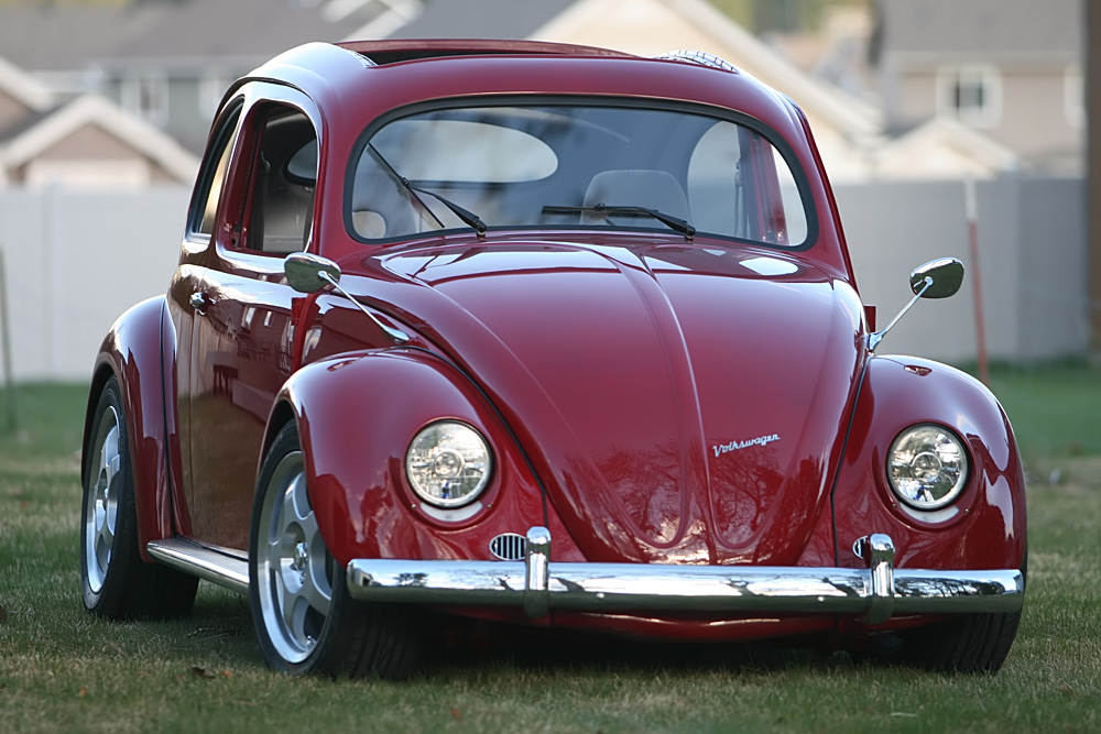

I've spent the last 5 years building this 56 VW Bug from the ground up. I narrowed the front beam 2-1/2 inches, installed 4 wheel disk brakes with a 4x100 bolt pattern, added dropped spindles and replaced both pan halves with near perfect German metal from a 55 pan. Body wise I left it mostly stock, but I did fill in the exhaust cutouts and frenched in the head lights. The trim strips have been removed but I plan on putting them back on since I opted for the swan neck mirrors.

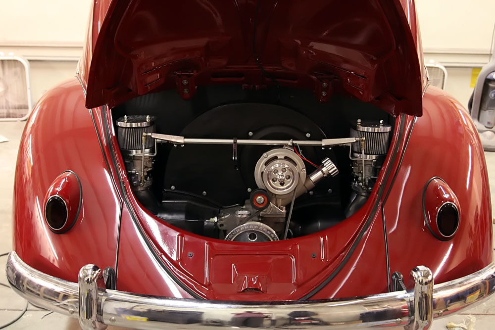

The engine is currently being built and should be done next month. It will be a 2110cc with 044 heads 40mm x 35.5mm valves and Webber 44 IDFs feeding it. I'll be bolting up an all stainless A-1 sidewinder 1-5/8" exhaust to round out the rear end.
I am currently gathering parts to jolt it. Unlike the other Volkswagens posted, you will not see any of the ignition parts in the car. The trigger wheel will be attached to the back of the crank pulley and the VR sensor will be mounted to the block out of sight behind the tin. The coil, EDIS, controller and vacuum can will all be mounted under the body between the fender well and transmission.

It runs! I was able to get the engine started on Sunday and have put about 75 miles on it already. I'm still working on getting the carbs dialed in at this point, but it's running pretty well. Once I get a few more miles on it, I'll start to tweak the ignition map. I have spent next to no time on detail work. I plan on pulling the motor this winter to strip and paint or powder coat all the tin. I wanted to get it in the car and running before I worry about how it looks.
As I had planned, the MegaJolt, EDIS and Coil pack are all mounted under the package tray behind the firewall. The trigger wheel and VR sensor are mounted on the back side of the crank pulley, so the only ignition components that are visible in the car are the #2 & #4 spark plug wires where they enter the heads.
