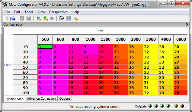

I have a moderate sized engine being built and plan to run a MegaJolt. Below are how I will be driving the car, the specs for the motor and the map I plan on starting with. Let me start by saying I know very little about ignition maps and I got this from the map library. Suggestions?
I'll be driving the car both around town and on the freeway up to about 75MPH but only on nice days. I live in the inland northwest where temps range from 40F to 90F. It gets much cooler and sometimes hotter, but I won't drive the car when it does. Altitude will be between 1900 and 2500 feet above sea level. I will also take the occasional long trip, up to about 250 miles but only once or twice a year. I do love to accelerate but I will keep the top speed at or below 75MPH. I will also take it to the strip and run it in a 1/4 mile once or twice, but I don't think it will happen with any regularity.

- Ignition Map
- Ignition Map.jpg (131.44 KiB) Viewed 24749 times
I have a stock tranny right now. It has a 388 RP and all stock gears. It came from a 69 originally. When I get my good one built, I'm thinking 412 RP likely with stock gearing as well but I have not decided on that yet. I'm running 205/60 15s on the rear end.Mario wrote:Hey Jestes,
What are your tranny ratio's?
When you get a little closer I can help you build up a new ignition map. I don't think that is very optimal for your combo and is under timed in most of the areas you will be using.
Your cruising RPM should be around 3200 with those rear tires this map isn't even all in yet. And with that cam you should be able to pull upto 7k at the track.

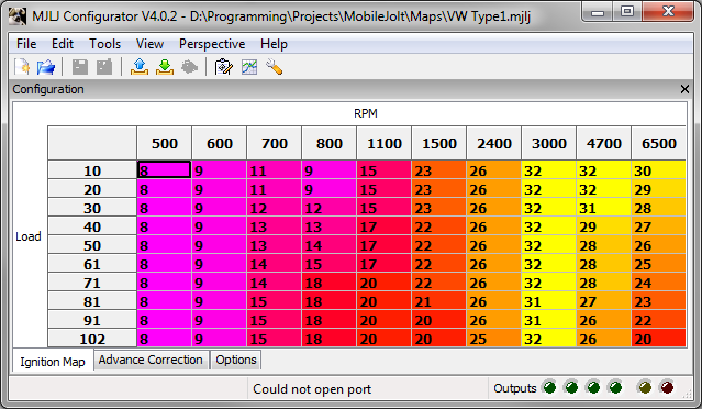

OK, I think I'm ready to start on the map. The engine has come back from the balance shop and is being assembled this week. I have the exhaust on order and should be here next week. I have all the ignition components except the controller. I expect to order that really soon. The carbs are sitting in my office and all the tin is in the shop ready to be blasted and painted. The trans has a 411 R&P, the rear tires are the same circumference as a 165R15, I don't remember the exact size, but I did keep it as close to stock height as possible. The cam is good for well past 6800, but the exhaust will stop me about there. What other tid bits do we need to create a good starting point for a map? I am considering wiring in the switch to use 2 maps, one for the street and one for the strip but I don't know if that is really necessary. Thoughts?jestes wrote:That would be great. Thanks.Mario wrote:When you get a little closer I can help you build up a new ignition map. I don't think that is very optimal for your combo and is under timed in most of the areas you will be using.

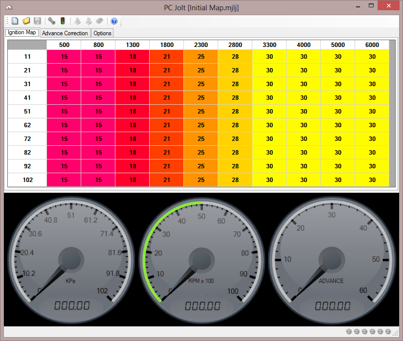

This is the map I plan on using. I'm shooting in the dark here, so any help would be appreciated. Better yet, is there any info on how to go about creating a map?

- Initial Map.png (41.84 KiB) Viewed 23936 times

Something like this? At 70 MPH, I should be around 3200, so I set that as my target for 30°. I too will be doing this on a brand new motor so the soft rev limiter is set to 5000.Lazeum wrote:To start, try with conservative timing.
Let say 15° at idle and 30° at 3500rpm and up.
Make a linear plot from those 2 points and get you first map. This is how I've done mine and it is not finished yet but I've always been on the safe side.
- Initial Map.png (136.17 KiB) Viewed 23903 times
That's exactly that!
With low rev limit and only soft rev limiter, my exhaust used to experience loud Bang when hitting max rpm so don't be surprised if it happens.
