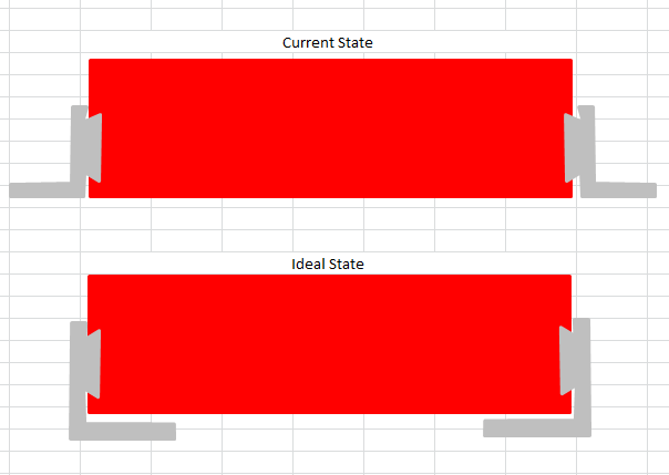

I am mounting RCP in a shifter kart, and the best and virtually only location is between my feet in front of the steering shaft. To keep the wiring block forward, that puts the two tabs on each side sticking out too far. That being said, can I get a spec on what is used for the housing/tabs so I can see if they make something else I could slide in the rail? Attached is an image of something closer to what I would like to be able to do.

We don't have exact specs on that, but you should be able to measure it fairly easily. One thing you definitely do is modify the flanges - first cut off the feet and then TIG weld a bottom plate that would extend underneath the RaceCapture/Pro unit.

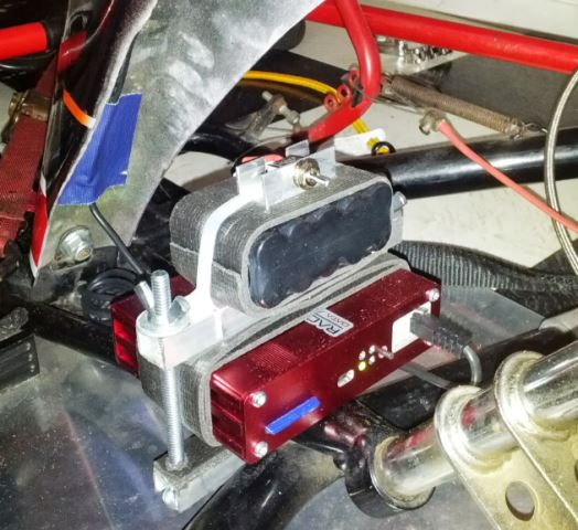

What I was really looking for was who manufactures the housing. Velcro wouldn't exactly do the job in my application. Below is what I worked up last night, there will be some more rubber added for vibration mitigation. Also still need to make a mount to hold the small rechargeable battery pack.
Updated picture with battery pack and switch.
RCP Mount3.jpg (54.67 KiB) Viewed 14331 times

I haven't messed with it a significant amount since I initially mounted it. The only usable data that I have gotten has been from the GPS. The vibration is so itense that it just oscillates peak-to-peak, so some serious isolation will be needed to make that work. You can see more details from diamondjack and I's discussion here: http://www.autosportlabs.org/viewtopic. ... highlight=
