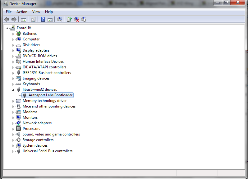

Post by Mr. Wednesday »
Device manager screenshot attached.
Device manager
Device manager
The ChumpCar/LeMon: 1988 Ford Mustang, with '87-'88 Thunderbird Turbo Coupe turbocharged engine. Covered in stickers, was #74, then #94, now #75.
We race in Texas and vicinity.
Thank you.
When RaceCapture/Pro is plugged in, try right clicking the "libusb-win32 devices\Autosport Labs Bootloader " and select, "Uninstall driver", and also select the option to delete the files.
Unplug and then re-plug RaceCapture/Pro. Does it prompt for drivers, or automatically re-install the bootloader drivers?
